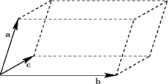

Consider a parallelepiped formed by 3 vectors, like this one:
Its volume is, up to a change of sign, equal to ##\mathbf{a\cdot(b\times c)}##, also known as the scalar triple product. Scaling either of ##\mathbf{a,b,}## or ##\mathbf{c}## scales the volume by the same amount.
The formula ##V=\mathbf{a\cdot(b\times c)}## mostly works, but sometimes we get negative values. This happens because our formula also depends on the orientation of ##\mathbf{a,b,}## and ##\mathbf{c}##, as per the nature of the dot and cross products. Loosely speaking, the scalar triple product tells us about the volume and the orientation of a triple of vectors.
In addition, allowing the volume to be signed gives us linearity: ##V(\mathbf{a_1+a_2, b, c})=V(\mathbf{a_1, b, c})+V(\mathbf{a_2, b, c})##. The same is not true in general when we take ##V## to be the absolute value.
The determinant works just the same way--linear in each argument, and equaling zero when the parallelotope flattens. (Hint: the 3x3 determinant is precisely the scalar triple product :wink:) Determinants are, in some sense, a generalization of the scalar triple product to an arbitrary number of dimensions.

so then ##a## is whatever element you choose, and ##b \times c## is the cofactor? I learned about spans and kernels when I took linear algebra in 2012, but I am not in the mood to learn it again right now.
