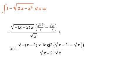

Now, I solved the integral two ways: one with Mathcad, and the other with The Integrator.
When I solve it with Mathcad, I get:
What is the Correct Equation for Finding the Centroid of a Circle?
which is wrong because the area calculated is negative. When I solve it with The Integrator, I get:
Handwritten-style integral of 1 minus the square root of (2x minus x squared) dx, with a worked antiderivative result below it involving square roots and a logarithm.
which is also wrong because if this equation where evaluated, you would obtain a number with imaginary components.
I type this equation into my TI-84 and had it calculate the area under the curve and it got an answer that agreed with the known value, so the equation for the curve is correct.
It's been awhile since I've used calculus like this, but this problem should be very straight forward; however, that is not turning out to be the case.
Where have I gone wrong?

These equations look correct to me. I get
[tex]\bar{x} = \bar{y}= \frac{r(10-3\pi)}{12-3\pi}[/tex]
That is exactly the answer. Can you please go into some detail about how you obtained it? Can you also explain why I am not getting the correct answer when I try integrating for the area under the curve?
