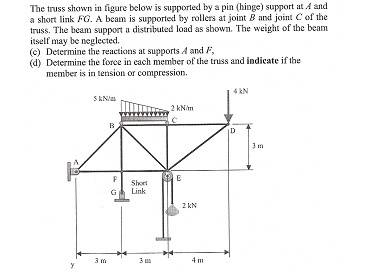

What is the correct FBD and equilibrium equations for a truss analysis?
2 replies · 3K views
jegues
1,085
See figure
[tex]\sum F_{x} = 0[/tex]
[tex]\sum F_{y} = 0[/tex]
[tex]\sum M = 0[/tex]
See other figure.
is the FBD for my truss correct?

jegues said:
See figure
See other figure.
Except for the typo error for the load applied at C (should be 4.5, not 4), your FBD is excellent, nice work.

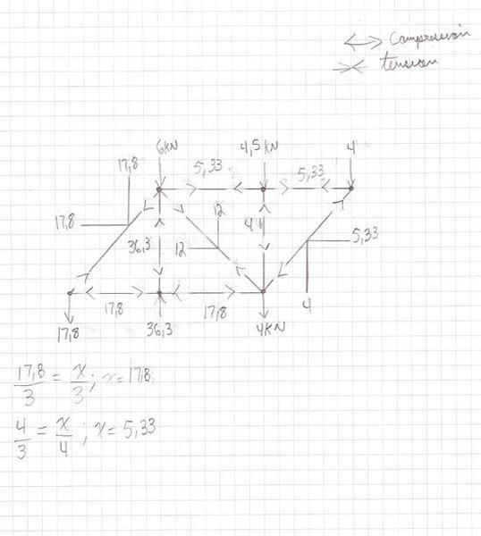

Now that I'm sure my FBD diagram and equilibrium equations are correct, I moved onto the actual truss analysis and I'm still not obtaining an equilibrium at all the joints within the truss.
Can anyone help me find my error?
This has been giving me quite the headache!
Thanks again.
EDIT: Fixed my error, got everything to work out ;)
