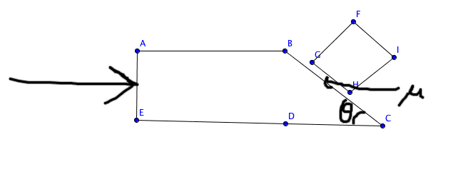

General question.
you are given theta, μ, and both masses. Find the acceleration of the system so the block does not slip.
Let m1 be the block, and m2 be the trapezoid car thing.
Let F be the applied force
I used a coord system with the x-axis along the area where the trapezoid touches the block. I came up with:
Fnet = m1 g sin θ - ff
Fnet = m1 g sin θ - u F sin theta - u m1 g cos theta = 0
Substituting for the system gives:
[tex]a = \frac{ -\mu_k m_1 g \cos\theta + m_1g\sin\theta }{\mu_k sin\theta (m_1+m_2) }[/tex]
Although i think this is incorrect since i did not account for the normal force of the car onto the block. Can someone correct this?

Please show your reasoning. I can see what ##\theta## and ##\mu## are, but which mass is ##m_1## and which ##m_2##? What does "ff" mean in your equations?
Since this is homework, we won't correct it for you.
What we can do is help you correct it for yourself.
