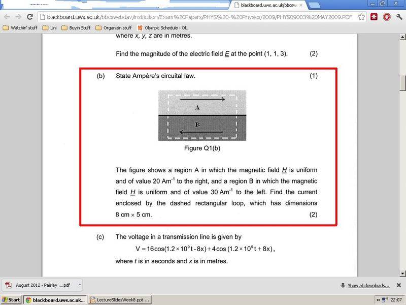

State Ampere's circuital law. The figure shows a region A in which the magnetic field [itex]H[/itex] and of value 20Am^-1 to the right and a region B in which the magnetic field [itex]H[/itex] is uniform and of value 30Am^-1 to the left. Find the current enclosed by the dashed rectangular loop, which has dimensions 8cm x 5cm.
[itex]\int_c H\cdot dl[/itex][itex]= I_{enc}[/itex]
So we already have a constant value for H for both segments and they are constant so I think its adding together two different values. So..
[itex]H \int \cdot dl = I_{enc} = H * (2x + y)[/itex] for x = 4cm and y = 5cm?
Or am I missing something?
i don't understand :redface:
where is the electric wire (for the current)?
what shapes are A and B, and where are they in relation to each other and the wire, and is anything moving? :confused:
Apologies perhaps the image itself will clarify and yes I have been that busy brushing up my Latex I forgot the more basic tools were there lol.
ah! :smile:
what does the "dot" do to the "vertical" bits? :wink:
(and you'll need an H1 and an H2)
For each half of the rectangles vertical sides the magnetic field moves in equal an opposite directions and therefore would cancel each other out? So it is just..
[itex]I_{1enc} = H_1 \cdot y = 20\cdot 0.05 = 1A[/itex]
[itex]I_{2enc} = H_2 \cdot y = 30\cdot 0.05 = 1.5A[/itex]
Seem correct?
no, you're missing the point (or the dot) …
H.dl is 0 because H is perpendicular to that part of the circuit! :rolleyes:
otherwise correct :smile:
