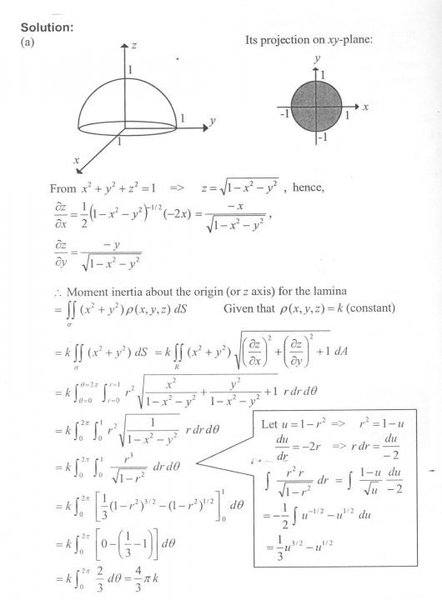

  • Handwritten solution to a moment of inertia problem for a hemispherical lamina, showing a 3D sketch of the hemisphere, its projection onto the xy-plane, and the double integral of (x^2 + y^2) rho dS in cylindrical coordinates.

The problem asks you to find the polar mass moment of inertia for the given body.
You can think of moment of inertia as the resistance to angular acceleration.
