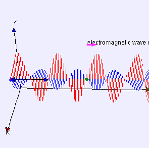

This isn't really a homework question, but I felt it was better suited here than in General Physics. I'm looking for more of a general explanation than anything. I was able to do my homework for this section on my own (mostly), but I feel like I still really have no idea what is actually going on.
So. Electromagnetic radiation. I feel like I'm missing something important to understanding. Basically what I know is this: moving charges can radiate an electric field and a magnetic field. How do we know what direction the fields radiate in? And how do we know in which direction they point? And finally, how can the phenomena be explained?

I guess the explanation behind EM radiation is pretty straightforward. I may have overcomplicated it in my head earlier. But I'm still not 100% confident on the directions of the fields/their propagation.
For example, how dow we know that in this situation, they propagate in the positive y direction?
If you look at the solution for source-free Maxwell's equations in free space, EM waves must have E perpendicular to B, propagating in a direction perpendicular to both E and B. Note that in the simple case of your animation, a charge in simple harmonic motion in the z-direction, they don't just propagate in the +y direction, they propagate out in all directions with an intensity proportional to (sin(theta))^2. So the intensity is maximum in the x-y plane, and drops off to zero in the +/- z-directions.

Sorry for not responding sooner - been extremely busy with school lately. One final question, I think I feel better about the rest of this so far.
If, in the example gif I posted earlier, the charge is accelerating parallel to the z axis, why isn't there a radiative field in the z-direction? It seems to me the electric field would be changing constantly at a fixed point on the z-axis. I suppose there would be no magnetic field because the motion of the particle would be parallel to the direction vector.

The instantaneous change in the electric field does propagate outwards - it's a relativistic effect sustained by the changing position of the charge and the finite speed of light. Whether you see a magneic effect depends on your relative motion. Not part of the classical model.
I brought up the relativity part just to get you thinking - which seems to have worked :)
Classically, EM radiation is a solution to Maxwell's equations that is, kinda, self-sustaining. For that you need an electric field changing in such a way that the resulting magnetic field will, in turn, change in such a way as to produce the original changing electric field and so on. For a charge oscillating along the z-axis (which direction is defined by the charge oscillations btw), there is no EM radiation along the z axis because the needed conditions do not occur in that direction. As you have noticed: no B-field.
For details, unfortunately, you have to do the math.
