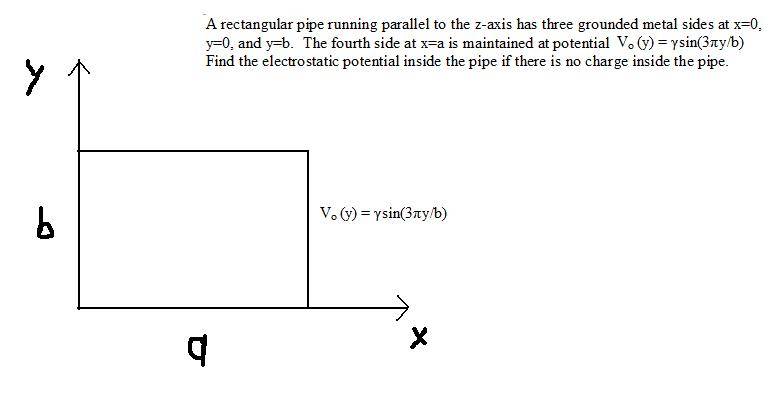

I'm guessing I need to use Laplace's equation in 2 dimensions since the potential depends on x and y. I have no idea how I would do this.

Ok so I tried working out a solution but I went wrong somewhere.
From separation of variables I got:
V(x,y) = (Aekx+Be-kx)(Csin(ky)+Dcos(ky))
Boundary conditions:
V=0 when x=0
V=0 when y=0
V=0 when y=b
V=v0(y) when x=a
D=0 by the second condition, and I can then absorb C into A and B:
(Aekx+Be-kx)sin(ky)
-A = B by the first condition:
A[ekx-e-kx]sin(ky) = Asinh(kx)sin(ky)
k = n∏/b by the third condition:
Asinh(n∏x/b)sin(n∏y/b)
Now I'm pretty sure I'm supposed to do some sort of linear combination here to solve for A.
I did this instead. I'm pretty sure it's wrong but I'm not sure why?
By the 4th boundary condition:
Vo(y) = Asinh(n∏a/b)sin(n∏y/b)
solved for A, then plugged that into Asinh(n∏x/b)sin(n∏y/b)
I guess I can't do that since Vo(y) isn't constant? Still though... why?

Sure you can do that as long is A comes out to be a constant. It must be a constant because you made the assumption that it was a constant.
The variation with y of Vo(y) is taken care of by something other than A in your solution.

Each value of n corresponds to a solution Vn, so you should write
$$V_n(x,y) = A_n \sinh (k_nx) \sin (k_ny).$$ The general solution is a linear combination of the individual solutions
$$V(x,y) = \sum_{n=1}^\infty A_n \sinh (k_nx) \sin (k_ny)$$ where ##k_n = n\pi/b##.
