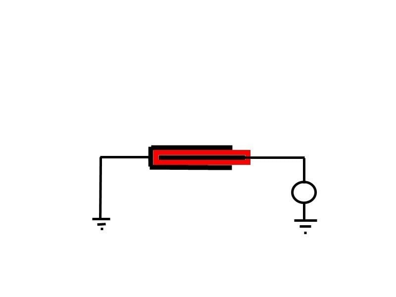

1. In above image an insulated metal plate has been placed inside Earth (soil), and an voltage is applied between plate and Earth groung what will be the capacitance here??
2. one plate is the metal and the other plate is entire earth, so it is a big assymetrical Capacitor or What?
all replies welcomed friends.
I think it will fail to work as capacitor almost all supply voltage will occur across the insulation of the buried plate.

I think it can be modeled as a capacitor. The insulation will act like the dielectric between the plates...
The capacitance will be roughly twice that of a two plate capacitor eg..
C = 2*εRε0* A/d

You might need to include some "equivalent series resistance" due to the properties of the earth.
I do not think resistance of the Earth's crust will appear in the formula for capacitance. It will only affect the time for charging. The simplest equivalent circuit appears to be consisting of three plates separated by two insulating sheets: the outer plates will be connected to the negative terminal of battery and the central plate to the.positive terminal of the battery.
if all votage appear across insulator, won't it try yo polarize it and store charge there by making capacitance?

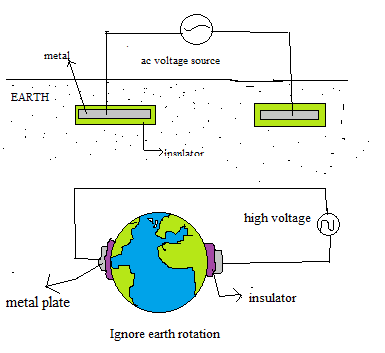

Friends now apply my same question here, what will you think the capacitance will be ?.
( both the images are same except the distances between plates inside the ground )
that's what I'm thinking Sir...please do see my second diagram also
Modelling wise you seem to be correct. But can we consider the whole soil of Earth as one conducting connection between two plates of a parallel capacitors.Just because we think the whole Earth is at same potential.

I treated it like a three plate capacitor with the two outer plates connected together. That's equivalent to two capacitors in parallel hence x2.

Looks like you have an AC voltage source driving two capacitors in series.
Thanks CW...
now that i see your picture it's crystal clear...

Re: top diagram of post #8. The two buried plates are in series, but the two sides of each are in parallel. That cancels to C = one surface plus wires.

In #8 he asked this
to which the answer is "Yes, capacitance stores energy in the electric field between its plates. That'd be in your insulating layer, with conductive Earth serving as second plate."
In #11 i should have said this instead of what i did :
jim hardy said:
If on the other hand the topsoil is not highly not at all conductive it becomes an insulating layer it just extends the insulating layer... ,
The key to envisioning capacitance is not its plates but the dielectric between them. HIs #8 post shows he grasps that.
Earth being only mediocre as either an insulator or a conductor, i thought it worth testing the two extremes to reinforce his thinking. And to refresh mine as well.
old jim
