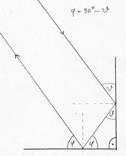

Make a drawing :)
  • Handwritten diagram of a light ray reflecting off a horizontal surface and a vertical wall, with angles labelled phi and theta and the note phi = 90° − theta.

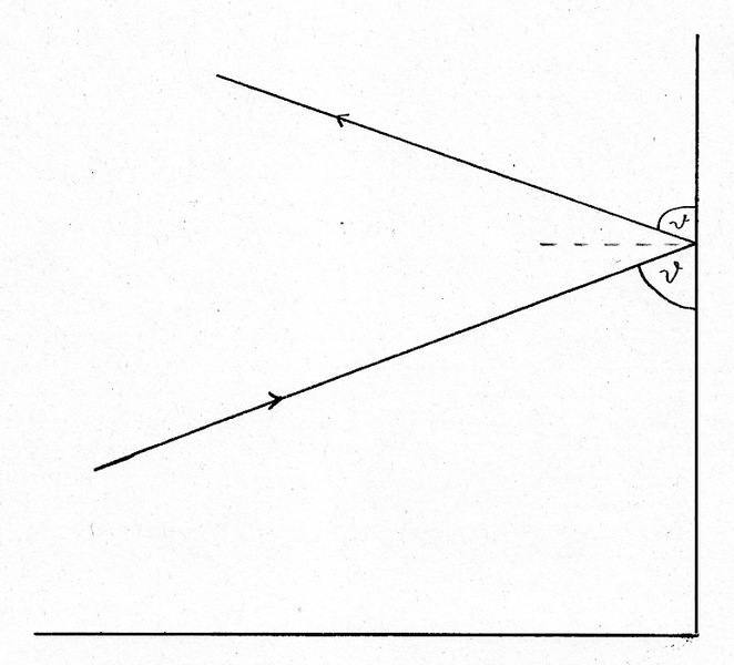

  • Handwritten ray diagram of a ray arriving from the lower left and reflecting off a vertical mirror on the right, with the outgoing ray going up-left; a dashed normal is drawn horizontally at the reflection point, and the angles between the rays and the normal are labelled theta.
let's call the mirror that the incomming ray initially hits mirror 1, and the other can be called mirror 2. the angle theta between the incomming ray and mirror 1 will equal the angle between the outgoing ray and mirror 2.
