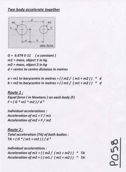

In Earth due to gravity if m is greater, greater the force need to move it..but what in case of space where has no gravity ?
What makes you think in space there is no gravity? Why does the moon stay in orbit?
This attachment might help:
Thanks to help...it was a silly mistake of my ...
...sorry ...it was a silly mistake of my ...
Glad to help, shift the mass from one to the other as you like, re-calculate the orbital data using the attached sheet.
You seem to be confused about several things. "On Earth due to gravity", it is harder to lift an object of greater mass because of its greater weight. On the other hand, it is not necessarily harder to move it horizontally. If there is friction, then the friction force will be proportional to the weight so greater for a more massive object, but if there is no friction, gravity will play no part.
Either on a frictionless surface or in space, far from any massive object, so that gravitational force is negligible (not 0), we still have inertia, Force is still "mass time acceleration" so a greater force is needed to start (or stop) the motion of a massive object- but not to keep it moving.
Newton's 2nd law F=ma or a=F/m holds everywhere so the greater the mass m is the more force F we have to put in order to achieve the same acceleration a. if we put [itex]F=F_{external}-B[/itex]and since the weight B is reduced in space due to the increased distance from Earth we can say we can put less force [itex]F_{external}[/itex] to achieve the same acceleration a, but i feel this is not what we had in our minds when we talk about this.
However what i believe we had in mind and happens inside a space station or a space shuttle in orbit around the Earth is that the gravity from Earth acts as a centripetal force rather than a pull down force. Inside a space station you just don't feel the gravitational pull from Earth though it exists, so i guess from that, one might get the delusion that gravity doesn't exist in space or that is easier to move things in space.
