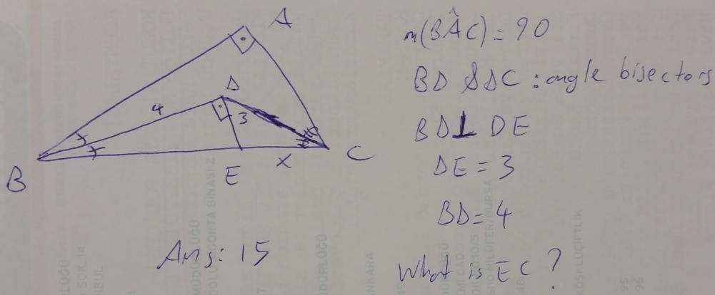

Hello,
what is the length of x in the attached?
I tried the following:
of course BE = 5, and also the point D must be the center of internal circle that is tangent to triangle and from there i came up with some equations together with the side ratio formulas of angle bisectors but it didnt work...
answer supposed to be 15

Your diagram is way out of scale.
Suggest you redraw it, making CE approx. 3 times BE.
Then extend BD to F (F on AC).
i know my diagram is out of scale. and that is not the question here.
we are supposed to solve this question in a test by knowledge of geometry, without using any rulers or calculators or anything, in 1-2 minutes. so we do not have the means or time to draw this to scale and solve it like that. everybody can do that. i would not take the time and effort to post it here, if i was allowed to do that. i can draw it in autocad and measure it too then... but this is not what is wanted, or something we can do during the test. we need to solve this by our knowledge of geometry, even if it is out of scale. . we will have only a pencil and a paper and an eraser when solving this.
1. Extend BD to F on AC as Wilmer suggested.
2. Express all angles in ${}_{{}^\times}$ and ${}_{{}^\times}\!{}_{{}^\times}$.
3. Deduce which triangles are similar.
4. Deduce the lengths of all sides, including $x$.
i extended the line to new point F
DF = DE = 3 as they are similar triangles with one side equal
also EC = FC now
after that ABC = DBE and i get some equations with really high numbers which also didnt give the result so either i made the equation wrong or something else... anyway, this is the way to go then...

Looks good!
But ABC is not similar to DBE...
It looks like this, doesn't it?

Perhaps it's easier to see the similar triangles now. (Thinking)​
