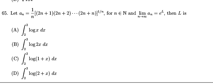

see attachment
limx->0(1+x)1/x=e
step 1: take log in both sides of an=...(as in function).
step 2: multiply and divide it by 2n inside the log.
step 3: there are n terms in multiplication so substitute 2(of denominator ) with all of the terms.
on solving it comes out to be ln2. which is equal to limn->infln an so final answer will 2.
I solve all the options but none of them give 2.
can you please tell me where am i doing it wrong.

you are solving relevant equation not the question i raised.
see attachment.
see attachment.
Of course, sorry.
Ok, so taking the log gives you log(1/n)+(1/n)*(log(2n+1)+...+log(2n+n)), ok so far? Now log(1/n)=(1/n)*n*log(1/n)=(1/n)*(log(1/n)+log(1/n)+...+log(1/n)). Add the two sums together and interpret it as a Riemann sum. Sorry to not be more accurate in notation here, but this is along the lines of a hint.

vkash said:
doesn't understand>:confused:
Well, I don't understand how you got ln2 either. If you can show that in more detail maybe someone can tell you why it's wrong. I'm suggesting to write out the sum you get from the log in such a way that it looks like a Riemann sum for an integral.
