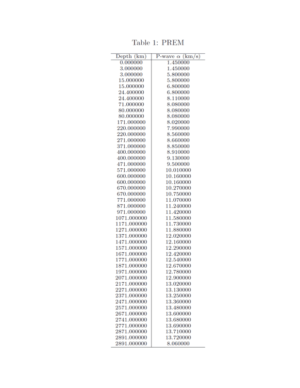

What is the maximum depth to which a P-wave ray can travel?
peeballs
For a spherical Earth (see Table 1 for velocity and depth, linear gradient),
what is the maximum depth a P-wave ray with p = 0:05 can travel to? If we
increase the ray parameter to p = 0:055 or p = 0:06, what are the maximum
depths these rays can travel to?

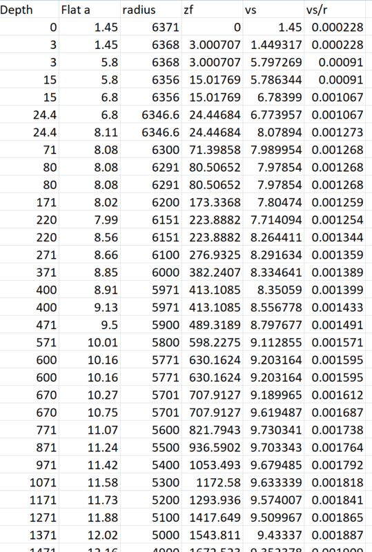

zf = -a*ln(r/a), (r/a)*vf = (a/r)*vs(r), 20/6371 = (vs/r)
I've created an excel spreadsheet with the given model in addition to calculating radius of the layer by subtracting depth from 6371. I've calculated Zf.
I've also found what I think is vs by doing alpha * (radius column/6371), but that could be wrong. I know I need to find where 20/6371 = Vs/r, but I think I made a mistake along the way because my solution doesn't include any answers that work.

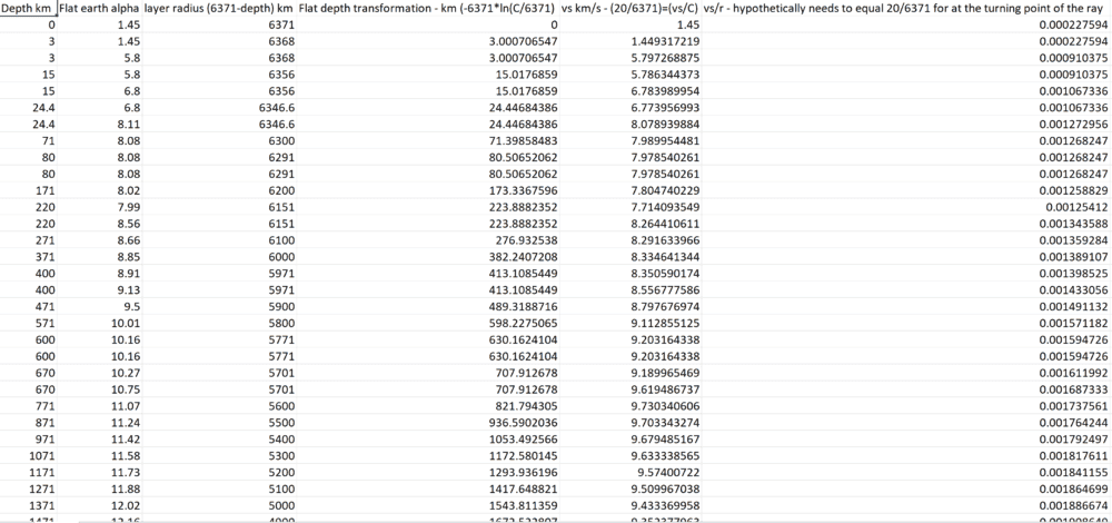

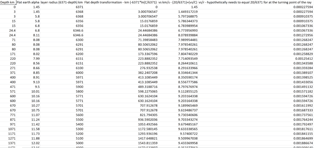

@BvU Here's another screengrab of the spreadsheet with more detailed units and formulas. Still confused. I don't use p because 1/p (i.e., velocity) is the relevant value I need - 1/p is the value I am trying to find depth for.

Table 1 merits some explanation. Why do some depths occur twice, and some alpha values occur twice, but staggered?
What does p=0:05 mean? Do you mean 0.05, and would that mean the velocity at max depth is 20km/s? I don't see any alpha values that high.
@haruspex
alpha is the p-wave velocity in km/s.
Some depths and velocities occur twice because they're the depths to the layer and the thickness of layers can be reoccurring, and since the velocities of p-waves in these layers depends on many factors, they may repeat as well. Table 1 is non-negotiable as it's given as part of the task.
The turning point (value I'm told to find) is where 1/v = 0.05 - so yes, the spherical velocity of the max depth is 20 km/s. I'm assuming that means I did the conversion wrong somewhere, which I'm asking about. I don't know where, though.
