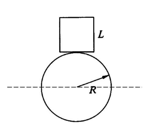

A cubical block of side L rests on a fixed cylindrical drum of radius R. Find the largest value of L for which the block is stable.
There is only one contact point between the cube and cylinder. There are three forces acting on the cube. The normal reaction from the cylinder, the friction and weight. The normal reaction and the friction pass through the contact point. Now how do I form the equations here? :confused:
Any help is appreciated. Thanks!

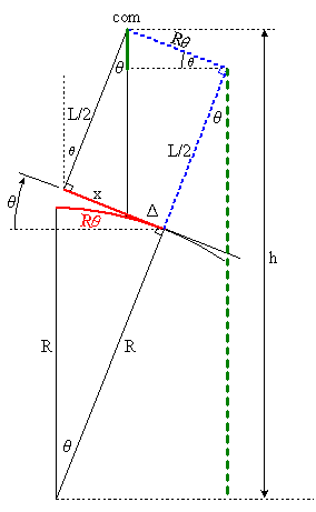

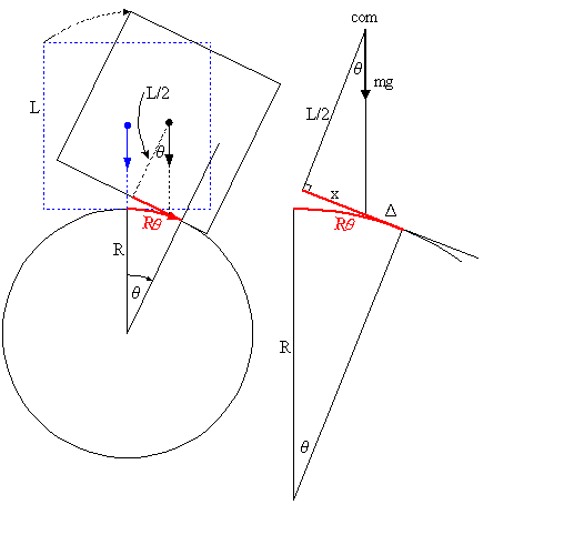

Consider the following drawing:
Does that suggest an approach? Hint: Consider the difference between the displacement of the point of contact on the face of the block to where the vertical through the center of mass passes through the same face (the line segment named Δ on the enlargement of the right).

Nice drawing gneill! :smile:
Is ##\Delta=R\theta-(L/2)\tan\theta##?

Yes indeed. The answer should be obvious from that...
How do I continue with voko's approach of finding potential energy? I need the distance of CM of cube from centre of cylinder but I don't see how to apply the geometry here. :confused:
In my drawing, extend the radius on the right by L/2 making it a total of R + L/2 in length. Then draw a perpendicular line from its end to the center of mass position. Treat the two as vectors to locate the center of mass.

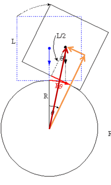

Please look at the attachment. Are you talking about the vectors shown? I still don't see how can I find the distance of CM from them. :(

That's the idea. Consider the direction of the torque provided by the weight of the block about its contact point. Under what conditions is it a restoring force? When is it going to make the angle of tilt increase? When will it be exactly neutral?
You have the lengths of both, and they are perpendicular. You've even drawn in the hypotenuse!

There are numerous right-angles joining the line segments, so anything tilted will make angle θ with respect to either the horizontal or the vertical. The trick is to determine which (w.r.t. horizontal or vertical). Fortunately the shape of the triangles gives a big hint, but even so you could follow the trail of perpendicular lines from the tilted radius vector and label the angles w.r.t. horizontal and vertical as you go. I've added a few annotations to the diagram -- see the thumbnail.

Yes, it must be because the two L/2 length line segments are parallel and the line you want is parallel to the bottom of the cube. The resulting figure is a rectangle.

Since ##\Delta \geq 0## and ##\theta## is very small, ##L\geq 2R##.

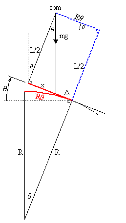

Okay, more diagram annotations. I draw your attention to the lines in green.
This is what I get:
$$\frac{L}{2\cos\theta}+\Delta \sin\theta+R\cos\theta$$
Looks good?
This might be easier in the vector language, which I think gneill suggested initially. Say the radius vector to the point of contact from the center is ##\vec{r}(\theta)##. The unit vector corresponding to it is ## \vec{u}(\theta)##. Then the extended radius vector is ## (R + L/2) \vec u ##. The tangential unit vector is ## \vec t (\theta) ##. So the position of CoM is ## (R + L/2) \vec u - R \theta \vec t ##. Then we only need the vertical component of the resultant vector to obtain the height.
Oh, and ## \vec t ## is obtained by differentiating ## \vec u ##.
And how do I find the vertical component? :confused:
What are the components of ## \vec u ##?
