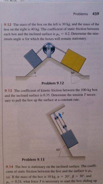

9.12)
The mass of the box on the left is 30kg and the mass of the box on the right is 40kg. The coefficient of static friction between each box and the inclined plane is μs = 0.2. Determine the minimum angle α for which the boxes will remain stationary.

As you can hopefully see, Box 1 is the yellow box on the right and box 2 is the blue box on the left. My problem is finding N in the second equation. It's just looking too nasty...
