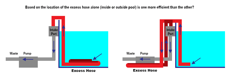

I have an above-ground pool which, tis the season for draining and winterizing. I have a 15 foot section of ribbed pool hose (designed for pumping) that I hook up to the pump and flush the pool with.
Pool is 4 feet deep both inside and outside, with a 1foot lip.
Hose needs to rise one foot from water surface over edge to get to intake.
I only need about 5 feet to reach from the pool bottom to the intake, and the hose only needs to rise about a foot out of the water. (So my head is 1 foot right?) The other 10 feet of hose I tend to drop into the pool - with the rationale that I'll get better pressure than if it were lying outside on the ground.
Is this true?
If, instead I left the excess 10 feet of hose outside the pool - i.e. I ran the hose from the bottom of the pool (4 feet up), over the edge (another foot up), then down to the ground (5 feet down) in a heap, then back up to the intake port (5 feet), would that make any difference in efficiency?
Head is still one foot (because the only thing that matters is the absolute distance from the surface of the pool to the intake.)
Amirite?
Would a syphon work?

The way I see it, if I understand the configuration from your description that he pump is located on the top edge of the pool, you are correct about the 1 ft suction head (but it is a negative head) and that is only only at the start because as the pool empties you will eventually reach a 5 ft negative suction head for the pump and it really doesn't make any difference whether the excess is inside or outside the pool, ie no advantage to placing it inside. On the other hand, as stated above, why not simply use the hose alone as a siphon without the pump. Alternatively, if there is a hose running to the ground connected to the pump discharge then this also acts as siphon and eliminates the negative head entirely throughout the draining process.

Here are the two arrangments:
Two diagrams of a pool pump setup with an excess hose; left shows the hose lying on the pool floor, right shows it routed outside the pool with its end on the ground.
The extra length of hose will add resistance to the flow.
As the water level drops the head to the top of the pool edge will increase (as noted), however, your drawings indicate that, once full of water, the hose/pump system will act as a siphon, so no head.
If you can extend the end of the tube outside the pool to a lower point it will act as a stronger siphon.. The increased pressure difference driving the siphon will add to the force of the pump.
Otherwise, you could make the hose shorter to reduce resistance (probably a small change).

DaveC426913 said:
My goal is to maximize efficiency. A syphon - while it would drain the pool eventually - would take forever.No. At the bottom.Yes, the efficiency will drop as the water level drops. Still, looking for best efficiency overall.Because I'm mortal. :wink:
If the pump is located at the bottom as you show then the inlet hose will act as its own siphon to feed the pump and since the only losses from the hose will be flowing friction related only to its length it makes no difference whether the extra hose is inside or outside of the pool.
The only other loss I can think of would be at the turns. They cause more resistance. Sharper turns make more resistance than more gentle sweeps.
You could also consider labor expenses (what's easiest). In or out, probably a wash unless one means you have to make a lot of sharp turns. Just put the hose where its easiest to set up and will remain stable.
