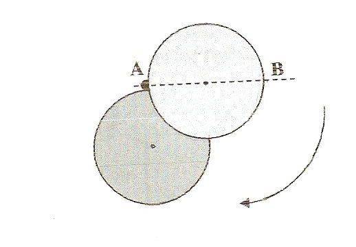

Hello,
I've tried all I could and get very confused about how to approach the problem.
Here it comes : A disk of mass M and radius R can rotates around an axis passing by the point A without friction situated on its circumference. The disk is in a vertical plane. We let it move freely when point B is at the same high than point A and point B is opposed to point A. (See figure to get clarification).
a)What is the tangential acceleration of point B just after the disk has been released?
b)What is its velocity when it pass by its lower point?
c)What is the acceleration of point B in function of the disk's position.
2. The attempt at a solution
First I drew the applied forces, which I think are the normal and the weight. The weight is applied in the center of mass of the disk that is in its center while the normal force is applied at point A and is constantly changing so I don't even know its magnitude nor its direction.
I believe that from a formula, [tex]\vec v_{B}=\vec{\alpha}\wedge \vec{r_{B}}+\vec{a}_{CM}[/tex].
I consider the origin of the system as being the point A. I want to know [tex]\vec{a}_{CM}[/tex].
From Newton, [tex]\frac{d\vec{P}}{dt}=m\vec{a}_{CM}=\vec{F}_e=Mgj+\vec{N}\Leftrightarrow \vec{a}_{CM}=gj+\frac{\vec N}{M}[/tex].
Thanks to the right hand rule, I got that [tex]\vec{\alpha}=-\alpha k[/tex].
So [tex]\vec v_{B}=-\alpha k \wedge Ri+gj+\frac{\vec N }{M}[/tex]. The only unknowns remaining are the normal force and the angular acceleration. I've no clue how to find them.
I also tried other things, like writing down [tex]\frac{d\vec L}{dt}[/tex] or even [tex]\vec L= \vec L_o + \vec L_s[/tex] where [tex]\vec L_o[/tex] is [tex]L[/tex] orbital and [tex]\vec L_s[/tex] is [tex]L[/tex] spin. I calculated [tex]L_s[/tex] to be worth [tex]\frac{3MR^2\vec{\omega}}{4}[/tex] and I believe that [tex]L_o=\vec R_{CM} \wedge mv_{CM}[/tex] and I have much more unknowns including [tex]mv_{CM}[/tex] which seems at least as hard as to find [tex]v_{B}[/tex]...
I must be missing many things. Can you help me please?

Keep it simple. Start by using Newton's 2nd law applied to rotation to find the angular acceleration:
[tex]\tau = I \alpha[/tex]
Thank you very much for your help Doc Al.
Your [tex]\tau=I\alpha[/tex] is my [tex]\frac{d\vec L}{dt}[/tex] and I sadly didn't realize it was worth [tex]I\alpha[/tex].
I wrote [tex]\frac{d\vec L}{dt}=\vec P \wedge \vec r + \vec N \wedge \vec r = -Mg\frac{R}{2}k[/tex].
By luck I calculated [tex]L_s[/tex]. Derivating it I obtain [tex]I\alpha[/tex] : [tex]\frac{3MR^2\vec{\alpha}}{4}[/tex]. (I didn't realize [tex]L_o[/tex] would be equal to 0. That's because the motion is a pure rotation so there is no translation I think).
So [tex]\vec \tau = -\frac{3MR^2 \alpha}{4}k[/tex].
Right now I don't see how I can calculate [tex]\alpha[/tex]. A little help would be appreciated :smile:
How did you calculate the rotational inertia?
Figure out the torque.
To calculate [tex]I[/tex] I used Steiner's theorem.
If I'm not wrong the moment of inertia of a disk rotating about an axis passing by its center is [tex]\frac{MR^2}{2}[/tex]. Using Steiner we have that [tex]I_{A}=I_G+Md^2[/tex].
I made an error, you're right : [tex]Md^2=4MR^2[/tex].
So [tex]I=\frac{9MR^2}{2}[/tex].
Ok I will. A bit later though...
Thank you.
This is still incorrect. (Where are you getting the 4?)
Sorry my fault, I took 2R instead of R the distance between the CM and A. I got confused with point B... nevermind.
So [tex]I=\frac{3MR^2}{2}[/tex].
Good. Now find the torque.
[tex]\vec \tau = \vec r \wedge \vec F=Ri \wedge -Mgj=-RMgk[/tex] which is worth [tex]\frac{3MR^2 \vec \alpha }{2} \Leftrightarrow \vec \alpha=-\frac{2}{3R}k[/tex].
Later I'll answer to question a). :approve:
Looks OK, but you dropped off a g.
Oops. Ok now I get it right.
As [tex]\vec a_T= \vec \alpha r[/tex] I get that [tex]\vec a_T=\frac{4g}{3}j[/tex] when the disk has just been released. Is it right? (I guess no because I should get [tex]\vec a_T=-\frac{4g}{3}j[/tex]...)
Good. Don't get hung up on the sign of the acceleration, that just depends on your convention. It's rotating clockwise, so the tangential acceleration is down and thus negative.

For the b) I have a question.
My attempt would be to find out [tex]\omega (t)[/tex] which I think is simply [tex]\int \alpha dt[/tex].
So that I can use the relation [tex]\vec v_B=\vec r_B \wedge \vec \omega_B[/tex]. But I doubt it will help since I don't know at what time it will reach its lower position.
Maybe considering the energy of the body? It is a pure rotation so [tex]E=\frac{I\omega ^2}{2}[/tex] but it makes no sense at all... [tex]E_{initial}=E_{final}[/tex] but [tex]\omega[/tex] changes and [tex]I[/tex] is a constant so it is not possible. I don't understand why I can't apply the law of conservation of energy. Can you (or someone else) help me?

fluidistic said:
So as [tex]E[/tex] is a constant in this problem, it must equals something else than [tex]\frac{I\omega ^2}{2}[/tex] but as the motion is a pure rotation I must say I'm missing something.
That's just the kinetic energy, not the total energy. It's the total mechanical energy that's conserved. (Don't forget gravity!)

One last question and I get the answer to part b)
From the conservation of the mechanical energy I got that [tex]\omega _f=\sqrt{\omega _i^2+ \frac{4MgR}{I}}[/tex]. How do I get [tex]\omega _i[/tex]?
Is it from [tex]\alpha _i[/tex] that I already got? If so, I'm lost.
Where did the 4 come from?
Assume the disk is released from rest.
Oh... yes of course. Second time I make a similar error. The angular acceleration can be different from 0 rad/s^2 while the angular velocity is worth 0 rad/s.
The difference of height between point B final position versus point B initial position is a diameter that is twice the radius (2R). So I took the origin of the system as being point B final position.
Thus [tex]E_i=\frac{I\omega _i^2}{2}+Mg2R[/tex].
[tex]E_f=\frac{I\omega _f^2}{2}[/tex].
Hence [tex]\frac{I\omega _i^2}{2}+Mg2R=\frac{I\omega _f^2}{2} \Leftrightarrow I\omega _f=I \omega _i^2+4MgR[/tex]. From it I reached what I wrote.
(I believe that point B reaches the bottom of the picture I uploaded, thus the difference of height of point B is 2R.)
That's true, but what matters is the change in gravitational PE, which depends on the change in position of the center of mass, not point B.
Thank you Doc Al, you're like a teacher. :wink:
Now I understand : when I have to consider the whole system which is a disk in this case, I must think about it as if it was only a point : the center of mass when it comes to potential energy.
I got the answer. (change the 4 I had for a 2).
