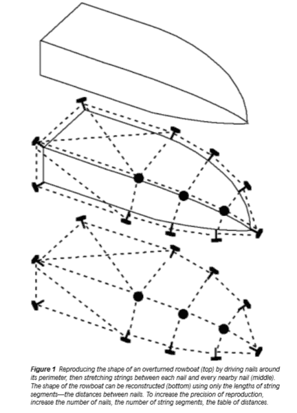

The reasons we think of curvature in regard with gravity are not as you describe, and don't involve "resisting velocity" at all.
For example, consider the procedure in figure 1 below, taken from Taylor's "Exploring Black Holes", downloadable from http://www.eftaylor.com/general.html, a procedure that allows one to get the "shape" of a 2d surface embedded in a 3d space.
Using idealized "strings" that minimize distance , and carying out this procedure on the "shape" of the equatorial plane of a static massive body (using rockets that hover in place rather than "nails") does not give results for this 2d surface that are consistent with a plane, but rather that of the 3d surface sketched below.
