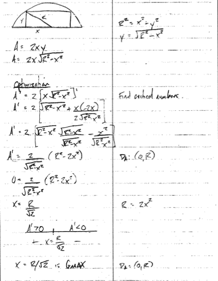

I'm really stuck on this problem. Could anyone provide some help?
Find the length and width of the rectangle of largest area that can be inscribed in a semicircle of radius R, assuming that one side of the rectangle lies on the diameter of the semicircle. Also, find the area of this rectangle. Draw a neat diagram.
Thanks!
Can you show us what you have tried so far so we know where you are stuck and can best offer help?
Absolutely - sorry for the delay! This is my understanding of how to "optimize" the problem:
So I've found the area, I believe. But I need to find the "rectangle of largest area that can be inscribed in a semicircle of radius R". I'm confused about how to do this. And what does the professor mean by "a neat diagram"?
  • Handwritten derivation: a rectangle inscribed in a semicircle of radius R with sides x and y, area A = 2xy = 2x√(R²−x²), derivative set to zero giving x = R/√2 as the maximum.
You have found the correct critical value:
$$x=\frac{R}{\sqrt{2}}$$
The base of the rectangle is $2x$. The height is $y$.
So, what is $$y\left(\frac{R}{\sqrt{2}} \right)$$ ?

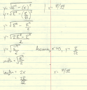

  • Handwritten derivation on lined paper: y = sqrt(R^2 - (x)^2), then y = sqrt(R^2 - (R/sqrt2)^2), y = sqrt(R^2 - R^2/2), y = sqrt(2R^2 - R^2)/2, y = sqrt(R^2/2), with x = R/sqrt2 noted, width = sqrt(R^2/2), length = 2x = sqrt2 R.
Or now I have to find area:
A = l * w
A = 2R/sqrt(2) * sqrt(R^2/2)
A = sqrt(2) * sqrt(x) * sqrt(x^2)
The base of the rectangle is:
$$2x=2\cdot\frac{R}{\sqrt{2}}=\sqrt{2}R$$
The height is:
$$y=\sqrt{R^2-\frac{R^2}{2}}=\frac{R}{\sqrt{2}}$$
Thus area = base times height:
$$A=\sqrt{2}R\cdot\frac{R}{\sqrt{2}}=R^2$$
