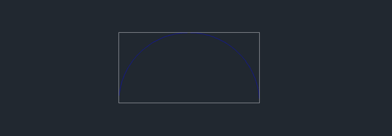

Karol
1,380
Maxima/minima are where the first derivative is 0
$$r^2=\frac{x^2}{4}+h^2~\rightarrow~h^2=r^2=\frac{x^2}{4}$$
S will be the strength of the light through the whole opening: the semicircle and the rectangle inside.
I take the strength of light through of light through the rectangle as 1 and through the colored glass as ##~\frac{1}{2}##.
$$S=\frac{1}{2}(\text{area of a semicircle})+\frac{1}{2}hx$$
$$S=\frac{1}{2}\left[ \frac{\pi r^2}{2}+hx \right],~~S'=\frac{1}{2}\left[ \left( -\frac{2x}{4} \right)x+h \right]$$
$$S=\frac{1}{2}\left[ \left( r^2-\frac{x^2}{4} \right)-\frac{x^2}{2} \right],~~S'=0:~~\rightarrow~~x^2=-4r^2$$
If i try the ##~GM \leq AM~##: ##~\sqrt{h^2x^2}\leq \frac{h^2+x^2}{2}##
In order to maximize the left side equality is when the elements are equal: ##~x^2=h^2~\rightarrow~x^2=h^2-\frac{x^2}{4}~\rightarrow~x^2=\frac{4r^2}{5}##
Both answers are wrong

As I read the problem you have a rectangle of height ##h## and width ##2r##, surmounted by a semi-circle of radius ##r##. The total glass area is ##A = A_2 + A_s##, where ##A_r## is the rectangular area and ##A_s## is the semicircular area. What formulas (in terms of ##r## and ##h##) would you use to get ##A_r, A_s?##
The perimeter is ##P = 2h + 2r + \pi r.## The light admitted is proportional to ##F =A_r + (1/2) A_s##, and you want to maximize ##F## subject to constant ##P##.
Other interpretations: perhaps the author intends "perimeter" to mean total perimeter of both glass pieces, in which case it would be ##2h + 6r + \pi r,## or perhaps the glass individual glass pieces are to be surrounded by a frame, and "perimeter" means the total length of all material in the frame. In that case it would be##2h + 4r + \pi r.## However, my guess is that he/she means the original interpretation ##2h + 2r + \pi r.## That is just the total length of the outside edges.
Karol said:
S=12(area of a semicircle)+12hxS=12(area of a semicircle)+12hx​
That equation states that all light goes through a semicircular area, and intensity is cut in half.
And that more light goes through a clear rectangular area, and intensity is also cut in half, contrary to the problem statement.
As I understand it, light enters a semicircular area, part of which is taken up by a clear window, and the rest taken up by colored glass.
I take that the perimeter of the clear glass is fixed, and is equal to 2x + 2h as one of the boundary conditions.

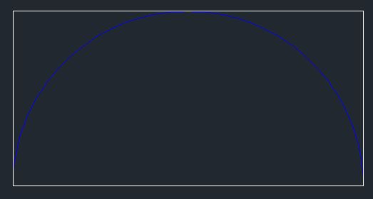

This:
Isn't a mistake. ifi interpret correctly, according to my drawing, then the light from the rectangular window adds to the light from the semicircle.
I took the whole semicircle.
Ray, your ##~2h + 4r + \pi r.~## means:
The rectangle isn't surrounded and it should be

No, that is not what it means. The perimeter of the rectangle is ##2h + 2(2r) = 2h + 4r## because each side has length ##h## and the top and bottom each have length ##2r## (which is the diameter of the semicircle).
Karol said:
View attachment 221891 The rectangle isn't surrounded and it should be
@Karol: "Surrounded" and "surmounted" don't mean the same thing. This is a typical problem seen in many calculus texts, and in my opinion "surmounted" means the semicircular window is on top of the rectangle shaped one, and the "perimeter" means the outside perimeter. I could be wrong. (But I don't think so :oldsmile:).

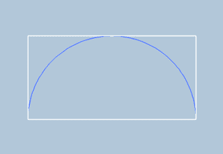

So it's:
Then the total glass area isn't ##~A=A_r+A_s##
Is a semicircle always exactly half a circle? if so then the proportions are fixed, h is always equal to r

Karol said:
So it's:
View attachment 221930 Then the total glass area isn't ##~A=A_r+A_s##
I could barely see the detail in this figure. I changed brightness values to get:
This is not the correct sketch for your problem.
Your figure in post #4 is the correct one.
The perimeter for this window in ##\ 2r+2h+\pi r \ ##.
