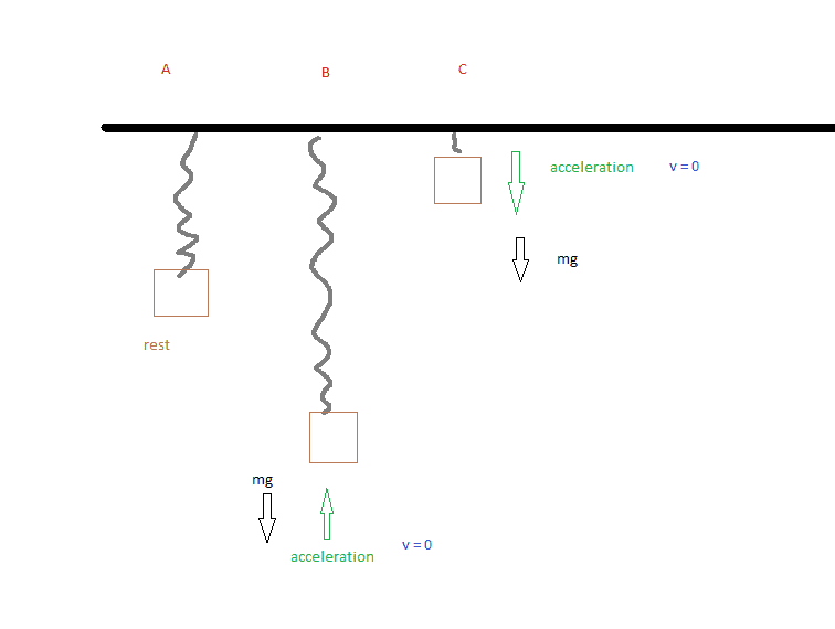

ok, i drew a drawing :
so at point C, isn't the spring exerting a force on the mass since it is decompressed?
also to answer the question , the f net at the mid point (aka the point where the block is at rest) is 0 so that is where acceleration of the spring is 9.8 m/s^2 but in the opposite direction of gravity.

goonking said:
ok, i drew a drawing : View attachment 82450
No. The lower end of the spring is at it's equilibrium position. It is stretched zero from equilibrium, so it exerts no force.
The mid point is indeed the place, but as far as the spring is concerned, acceleration of the spring means nothing. At that point, (the mid point), what is the acceleration of the object hanging on the end of the spring?

in my drawing, point A is the spring at rest, then at B, i pull the spring downwards, then it goes past point A into C, then into A again, then back to B, then A, then C.
so at point C, the only force acting on the block is gravity? doesn't a spring exert a force if it is compressed?
Ah Hah ! I think I see some of the problem you're having.
As I read the problem statement: (Yes, there are some assumptions built into this.)
A spring is attached to the ceiling. Of course, it hangs down relaxed, unstretched, but also uncompressed, with the free end at its equilibrium position.
With the spring is in this state, an object is carefully attached to the end of the spring, fully supported some way. The object is then released and descends to a point which is 1.19 meters below the location at which it was attached to the spring, comes to rest for an instant, after which it begins oscillating .​
The object does not go any higher than the point at which it was released. The spring is never compressed.
At the mid-point the acceleration is zero so the net force on the object is zero. Furthermore, at this mid-point position, the object is not at rest, in fact its maximum speed is at mid-point.

side question, but if the mass is at the highest point, like at point C in my drawing, wouldn't the magnitude of acceleration of the block be faster since it is being pulled by the spring AND being pulled down by gravity? so basically, what I'm asking, is the block when it is going down, faster than when it is coming back up, where it is going against gravity?
No, gravity has no affect on the motion because a portion of the spring force cancels out the gravitational force:
At equilibrium:
-ks + mg =0
During oscillation:
-k(s+x) +mg = mx''
-kx +(-ks + mg) = mx''
-kx = mx''
