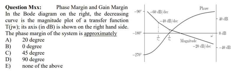

What is the phase margin and gain margin for this circuit?

I am having trouble visualizing this. So I know that the phase margin is how much phase lag it would take to make -180 phase at the 0 dB gain frequency. I am just having trouble placing this on the plot. It isn't a homework question I am preparing for an exam. I would think the answer is 45 degrees ?
Notice that at 180 deg phase shift the gain is still > 0dB!
I'm not sure what I am supposed to looking at to figure this out then
rude man said:
If gain margin is negative, so must phase margin be, making what your answer?
So then my answer would be none of the above so it can be negative ?
