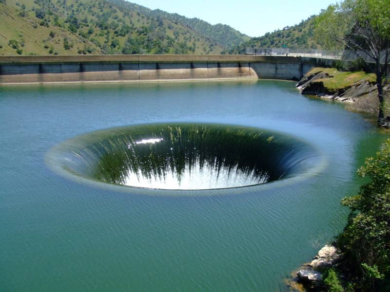

If you're looking for physical meaning, it always reminds me of this picture.

Great example of a Morning Glory spillway, designed several. Very interesting hydraulics not so much at the circular weir but once you get down into the receiving pipe and the down stream conditions.
Also called a Glory Hole and Bell Mouth spillway
Wouldn't want to get stuck in one, not likely to survive
https://www.bing.com/videos/search?...D1595D409C8E9C3DC4A1D1595D409C8E&&FORM=VRDGAR
Certainly is a interesting flow system also could be an analogy to a black hole with the weir lip as the event horizon and the region of no return unless radially outward local velocity greater than the critical velocity for the local water depth.
