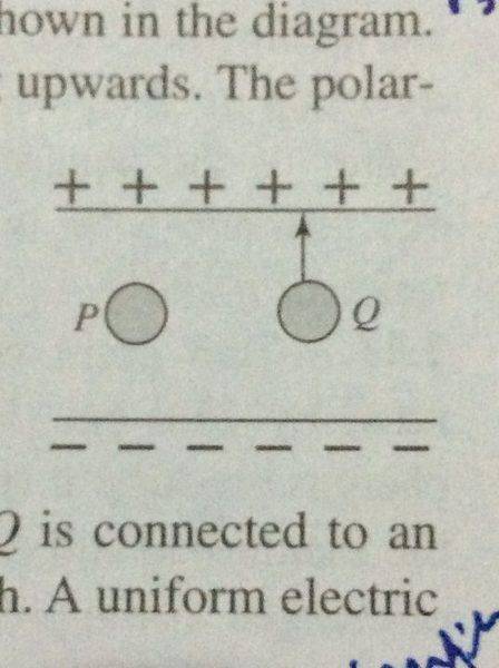

in a milikan type experiment there are two oil droplets P and Q between the charged horizontal plates, as shown in the figure. Droplet P is in rest while Q is moving upwards. The polarity of charges on P and Q is:
P. Q
a). +. +
b)neutral. -
c). - -
d). +. -
select the correct option.
Please check the image I've attached

Q is moving towards +ve plate, it must be negatively charged
P is not accelerating. It must be neutral.
So option B should be the correct option.
But the text says its C
What forces are acting on each droplet?
Does B indicate a neutral particle?
Must P be neutral? What forces are acting on it besides electrical?
I'm sorry, I didn't get you guys..I think only electrical forces are acting...
option B implies P is neutral and Q is negatively charged.

Oil drops are not massless...

A quick google search for "millikan oil drop" would be well worth the effort.
In a nutshell, you can't disregard gravity here.

It can be answered so long as you get all the assumptions right for the given problem. You assumed that gravity was not a factor, which turned out to be incorrect given the "Millikan context".
