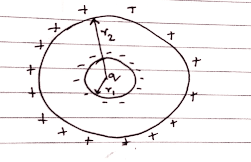

A conducting sphere of radius r1 is surrounded by a dielectric layer of outer radius r2 and dielectric constant e_r if the conducting sphere is given a charge q, determine the surface charge density of polarization charges on the outer surface of the dielectric layer.
$$\vec E_{net} = \frac{\vec E_{applied}}{\varepsilon_r}$$
The net Electric field(inside the dielectric):
$$E_{net} = \frac{1}{4\pi \varepsilon_0 \varepsilon_r} \frac{q}{r^2}$$
$$\vec E_{net} = \vec E_{applied} - \vec p$$
where p is the polarization vector.
let charge ##q_{-}## be present on the inner surface of dielectric and ##q_{+}## on the outer surface of the dielectric.
$$\vec p = \frac{q_{-}}{4\pi \varepsilon_0 \varepsilon_r r^2}$$
$$\frac{1}{4\pi \varepsilon_0 \varepsilon_r} \frac{q}{r^2} = \frac{1}{4\pi \varepsilon_0}\frac{q}{r^2} - \frac{q_{-}}{4\pi \varepsilon_0 \varepsilon_r r^2}$$
after simplifying you get:
$$q_{-} = q(\varepsilon_r - 1)$$
$$|q_{-}| = |q_{+}|$$
therefore the final answer(surface charge density on the the outer surface of the dielectric):
$$\sigma_{+} = \frac{q_{+}}{4\pi{ r_2}^2} = \frac{(\varepsilon_r - 1)q}{4\pi {r_2}^2}$$
I have obtained option (c) but the correct answer is (d), I am unable to see why there should be ##\varepsilon_r## in the denominator of my final answer, is there a mistake in the answer given?
or have I severely messed up some where?
If dielectric surface is vacuum dielectric constant is 1 and we would observe no charge so I think (c) or (d) is a right answer.
If dielectric surface is metal dielectric constant is + infinity and we would observe opposite sign charge so I choose (d).

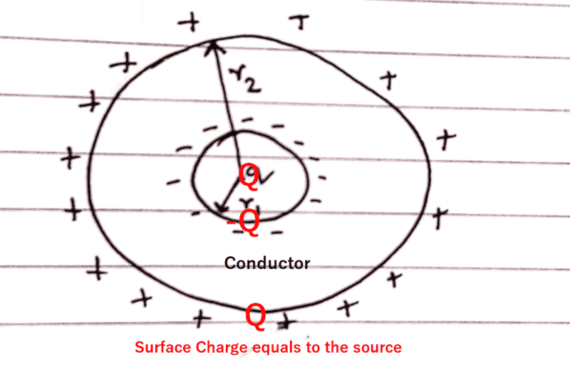

I regard conductor has infinite dielectric constant. Please imagine shielding by surrounding conductor.
this is what the setup looks like, the conductor is surrounded by the dielectric and not vice versa so again I am unable to understand what you are trying to say, could you maybe tell me if there is a mistake in the steps of #1.
So the surface charge density is
[tex]\frac{Q}{4\pi r_2^2}[/tex] for infinite ##\epsilon_r##. (d)
no I don't think the charge on the outermost surface will be Q since there hasn't been a dielectric breakdown, the charge density on the outer surface must be ##<\frac{Q}{4\pi {r_2}^2}##
edit: ok I think I understood your logic supporting why option (d) is correct but how could we arrive at that from first principles?
For finite ##\epsilon_r## yes. You see (d) satisfies your inequality. (c) does not.
And please remind that I have said about conductor infinite ##\epsilon_r##.

Another approach. The radial component of ##\boldsymbol{D}## is continuous at the interface ##r=r_2##. At ##r = r_2 - \delta## you have ##E_{-} = D/(\epsilon_r \epsilon_0)##. At ##r = r_2 + \delta## you have ##E_{+} = D / \epsilon_0##. So ##E_{+} - E_{-} = (1-\epsilon_r^{-1}) D/\epsilon_0##. But the jump condition on the electric field is ##[E] \equiv E_{+} - E_{-} = \sigma / \epsilon_0##, therefore\begin{align*}
\dfrac{\sigma}{\epsilon_0} = \dfrac{D(1- \epsilon_r^{-1})}{\epsilon_0} \implies \sigma = D(1- \epsilon_r^{-1})
\end{align*}By Gauss' theorem, ##4\pi r^2 D(r) = q_{\mathrm{f}} \implies D = q / (4\pi r_2^2)##. So\begin{align*}
\sigma = \dfrac{q(1- \epsilon_r^{-1})}{4\pi r_2^2}
\end{align*}
