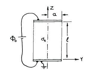

Determine the potential [tex]\phi[/tex] inside a resistor of length l and radius a.
Also determine the current density J, resistance R, surface and volume charge density Pe and Pes. The resistor is homogeneous.
V=Ed, d=l here
V=El
E = J/[tex]\sigma[/tex]
So V= J/[tex]\sigma[/tex] l ?
With your attempt so far, you can find the electric field. Then use that to compute the potential difference between one end of the resistor and a point somewhere in the middle. That should get you started.
