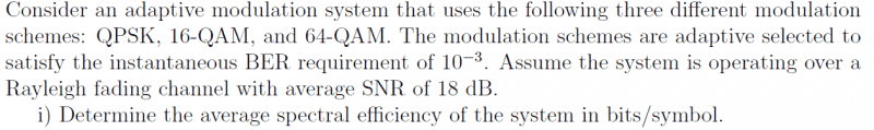

What is the Probability of Error in an Adaptive Modulation System?
  • Thread starter Thread starter JeeebeZ
    Modulation System
JeeebeZ
40
2. Homework Equations
I can't figure out how to get those numbers, I think I have to convert from dB when actually calculating it but I'm unable to get those ones.
I have
PQPSK = 0.502368
P16QAM = 0.0526855
P64QAM = 0.000004
Pno = 0.4450

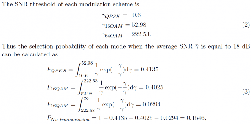

I figured it out,
Those are not in dB, even though I thought they were. So I was converting everything from dB or nothing from dB
so the integral ends up being -exp(gamma/gamma_bar) evaluated from a to b.
-exp(-52.98/ ( 10^(18/10) )) + exp(-10.6/ ( 10^(18/10) )) = 0.413505
-exp(-222.53/ ( 10^(18/10) )) + exp(-52.98/ ( 10^(18/10) )) = 0.402453
+ exp(-222.53/ ( 10^(18/10) )) = 0.0293970
