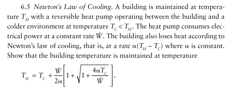

A building is maintained at temperature
TH with a reversible heat pump operating between the building and a
colder environment at temperature TC < TH. The heat pump consumes electrical
power at a constant rate W . The building also loses heat according to
Newton’s law of cooling, that is, at a rate (TH – TC) where is constant.
Show that the building temperature is maintained at temperature
dQrev/T = 0

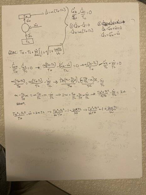

I have went about this problem many different ways but cannot seem to come up with the answer. I am essentially trying to prove the formula provided in the ss of the problem.Could someone help me and tell me if I am approaching this wrong?

I haven't gone through your entire approach (my eyes aren't what they used to be). But since the heatpump is reversible, we can assume it operates as an ideal Carnot engine. It has the efficiency:
[tex]\eta = \frac{\dot{W}}{\dot{Q_H}} = 1 - \frac{T_C}{T_H}[/tex]
Now, what's [itex]\dot{Q_H}[/itex]? It's the rate at which heat leaves the hot-sink, right? The rate that heat leaves the building. You have another formula for that rate.
I would start there. (Hint: There's some signifiant algebra involved, and if you find yourself with a quadratic, you might be on the right track.)

Not my area but, since no one has replied yet, maybe this will help. I think a different approach is required,
Do you know how to express the coefficient of performance (heating) of the heat pump in terms of ##T_C## and ##T_H##?
If not, take a look here: https://en.wikipedia.org/wiki/Coefficient_of_performance
Energy is being supplied to the building at a rate of ##\dot W .COP_{heating}##.
Since this will equal the rate of heat loss, ##α(T_H-T_C)##, you can write an equation which should give a quadratic equation in ##T_H## that you can solve.
But the algebra looks like it will be a bit messy!

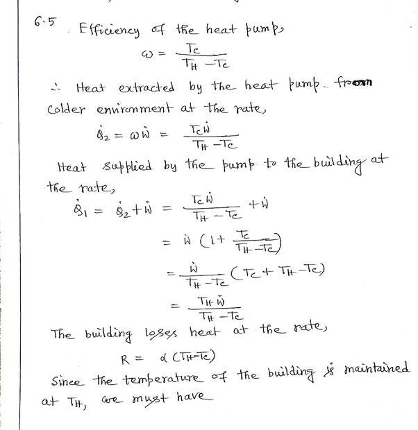

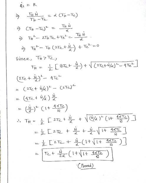

Hey, so I got close to the solution of this problem but kept coming up short. I ended up referring to a solution someone else posted but am I bit lost on the algebra.
I am a bit lost on the jump to forming a quadratic equation. How is it that Th2 turns into Th.
View attachment 297339View attachment 297340
If you are OK up to:
##T_H^2 - T_H(2 T_C + \frac {\dot W}{\alpha}) + T_C^2 = 0##
then compare this to the standard quadratic equation
##ax^2+ bx+c=0##.
Instead of ##x## we are using ##T_H##.
The constants are:
##a = 1##
##b = -(2T_C + \frac {\dot W}{\alpha})## and
##c = T_C^2##
To get the value of ##x## (i.e. ##T_H##) we use ##x = \frac{ -b± \sqrt {b^2 – 4ac)}} {2a}##.

That makes so much sense. Thank you so much
