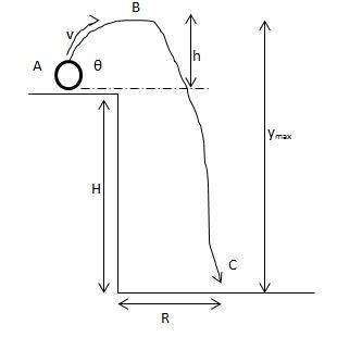

What is the proper formula for ##Y_{max}## for this trajectory?

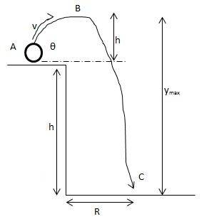

246319
Time it takes from A to travel to B; ##T = \large\frac{Vsinθ}{g}##
Max height object can reach, ##h = \large\frac{V^{2} sin⁡2θ}{g}##
Time it takes for for B to travel to C; ##T = \large\sqrt\frac{2y_{max}}{g}##

Benjamin_harsh said:
Max height object can reach, ##h = \large\frac{V^{2} sin⁡^2θ}{g}##
[Corrected your LaTeX]
You can read the answer from the givens on the drawing and from one other number you have already calculated.
Edit: Note that @kuruman interpreted your error differently (and likely more correctly).

Then what is the formula for Max height & ##Y_{max}##?
You tell us. Given the initial vertical velocity of a projectile, how high can it get?
##y_{max} = \large\frac{V^{2}sin^{2}θ}{2g}\normalsize + H## (Here ##H## is the height of the cliff.)
##h = \large\frac{V^{2}sin^{2}θ}{2g}##
That is correct.
