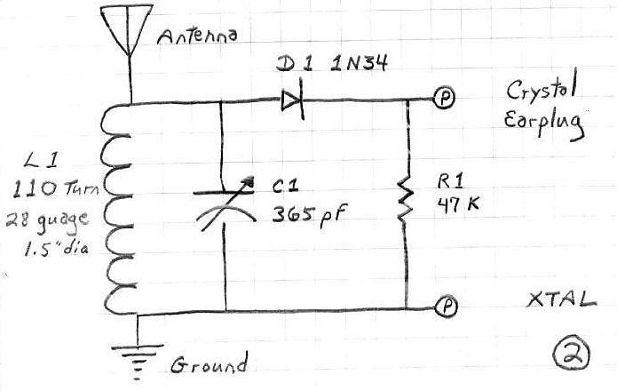

a basic tuned circuit ... an inductor in parallel with a capacitor along with a detector diode and you have a radio receiver...

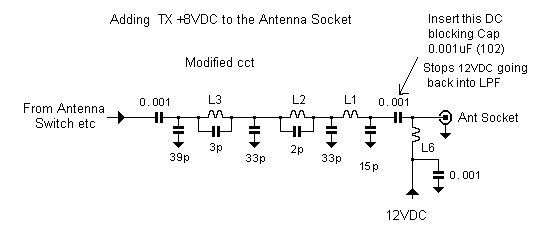

in this circuit below from my VHF (144MHz) transceiver radio I did a modification so I could inject 12VDC into the coax cable to power a preamplifier up at the antenna.
You can see a number of inductors in this circuit ... L1, 2, 3 and the associated capacitors are filtering of the output to stop harmonics of 144MHz from being radiated.
L6, I added, this inductor will pass the 12V DC, but because of its value, will block the 144MHz transmitted signal from getting into the 12VDC power supply
This is a common use of inductors in RF circuits, these type of inductors are called RF Chokes
