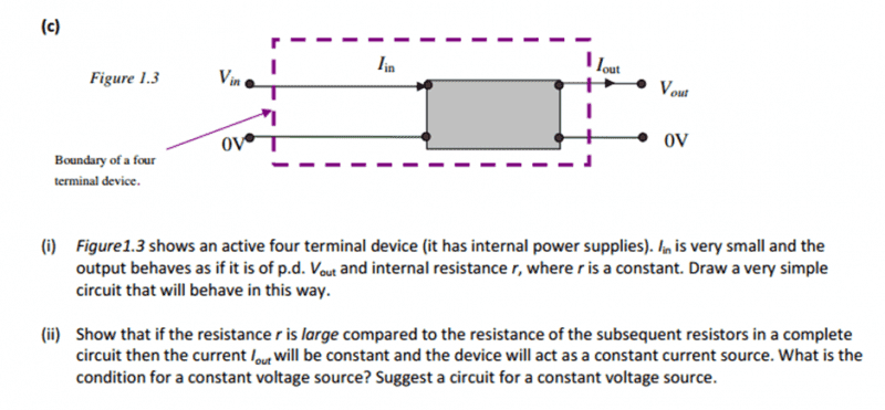

Thank you so much to everyone that has replied! I really understand the role of the capacitor and inductor now, however I am confused about the rest of the circuit. meBigGuy, could you explain what the earthing does and how it works in this circuit? There is also the circuit on this link
http://www.physics.ox.ac.uk/olympiad/Downloads/PastPapers/BPhO_Round_2_Paper_2011_%20Solutions_selectedl_answers.pdf
and the circuit is under question 2c)

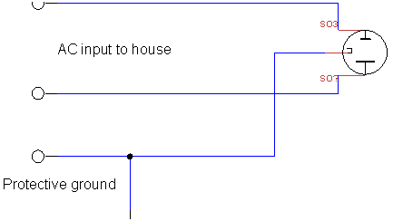

The AC input to a house consists of two (or maybe three) AC lines. Earth (ground) may or may not be supplied from the power station. If it is not supplied, it is used as a protection for human beings. Otherwise, a short circuit to the metal shell of a stove or a washing machine could become very unpleasant when you touch it.
Otherwise, in an electronic circuit you have power supply lines. Tradition has it that the supply line connected to the negative pole is called "ground" or "earth" even if it is not connected to "Protective ground". Handling "earth" in an electronic product is an art in itself, and gets harder all the time (FCC requirements to radiation play a large part here).

What about in this circuit though:
It seems to me like the earthing to get 0V is necessary in this circuit, even though I don't know why...
seems to me you've already fallen into the "earth as absolute zero" mental trap.
Would your fig 1.3 gizmo work in an airplane, or on that asteroid that's due to fly by here in a couple days? Sure it would.
It needs no connection to earth.
Definition of voltage is potential difference
ie between two points of your choosing.
Voltmeters have two probes for that reason.
It was a revelation for me when i learned definition of potential,
the work required to bring a unit charge from some point to wherever you are.
That "some point" is your point of reference.
The closest we EE's can come to "absolute potential" would be the work required to bring that charge from infinity to where we are.
Since we have no way to do that we do not know Earth's "absolute potential".*****
so we always use terms potential , and voltage, to mean referred to someplace nearby
There's no reservoir of charge that's at absolute zero voltage.
Practice this for a few days
"whenever I say "voltage" i will append the phrase "from (measured pointA) to (reference pointB)"
pointA being the place where i have connected my meter's red wire
pointB being the place where i have connected my meter's black wire
in saying it right you will come to think of it right.***** even though some guy got a patent on an apparatus to measure it, http://www.google.com/patents/US4839581

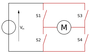

Here's the simplest way to get AC out of DC
you keep two and only edit: two switches closed at any time,
S1 & S4 for a while
S2 & S3 for the next while
motor M sees its applied voltage reverse every time you change the switches.
Now - what will your voltmeter report during each of the above "while's" if you connect its + lead to M's left side and - lead to M's right side?
While S1 & S4 closed : ?
While S2 & S3 closed : ?
Next - what will your voltmeter report during each of the above "while's" if you connect its + lead to M's right side and - lead to that bottom wire joining S2 & S4 & voltage source?
and with meter + connected to other side of motor, - to same bottom wire ?
Keep at it until your mind thinks like a voltmeter.

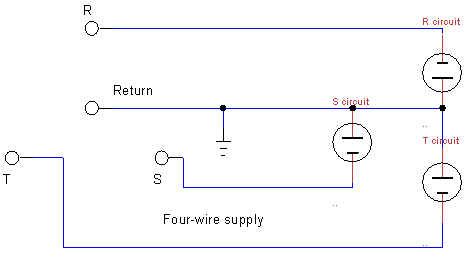

Yes - and no. It depends on what type of system your local power company uses. A short explanation (caveat: I describe the European standards, I do not know the standards elsewhere). For reasons lost in the mists of time, power companies deliver three-phase power to the homes. This means that relative to an arbitrary reference potential you have three AC voltages - R, S and T - with 120° phase difference. Older power systems used just these three phases pairwise as in the figure marked "Three-wire supply". Protective ground had to be supplied locally, and regulations exist as to how to create that ground.
A newer standard is the four-wire supply. We still have R, S and T, but in addition a fourth wire ("Return") is used. Now the AC voltages are tapped between each of the phases and the Return line. In theory the Return line is at protective ground level. Another difference is the voltages at R, S and T - since we now use the voltages between each of the phases and Return, the voltages between the phases are higher than for the three-wire system. Due to the 120° phase difference, they are increased by a factor of √3.
Then realize you've made a giant step for physics students, you no longer need that mental crutch of Earth as an electrical anchor.
If a circuit is not earthed, its voltage to Earth is indeterminate, that is it's unknown. Think on that and see what questions it brings up.
Good luck in your studies. Your questions are interesting; someone like you who probes the very basics can come to a most solid understanding of them.
old jim
Oh! I get what you mean about the reference voltage. In the four terminal circuit the 0V just means that the Vin/out are at this potential above the bottom two. But then how on Earth do you have so many terminals of different voltages? Wouldn't the charge carriers at a higher voltage just flow down to the lower voltage so that no different voltage terminals are possible?
And with the motor circuit, would the voltage across the motor produced be sinusoidal like mains current because of a back emf? Otherwise, it seems to me like it would just have dc voltage being +v and then -v when you flick the switches...
And thank you so much for answering my questions! I'm always amazed by how generous everyone of PF is with their time and effort :)
Indeed, the motor will see only the two DC voltages, not a sine wave.
We call that a square wave , if you graph it you'll see why.
There do exist complicated machines that pulse the switches very fast for varying durations
to generate a series of short duration rectangular voltage pulses, all the same height(Vin) but of varying widths.
With clever control of those widths one can make the applied voltage have an average value quite close to that of a sinewave, we call that PWM for pulse width modulation.
For a mind-blowing investigation into that principle see "Magic Sinewaves" by Don Lancaster
http://www.tinaja.com/glib/msintro1.pdf
most PWM sinewave approximations aren't so esoteric, though.

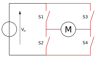

That four switch converter is called an "H Bridge" - what's in a name, huh ?
search on H Bridge PWM
dotted line approximates short term average of pulses (remember it's the area enclosed smoothed over time)
Can you tell which two switches are closed during each gray pulse?
There's your AC approximate sine from DC
you'd add a filter to do the physical smoothing if you wanted a cleaner sinewave, probably combination of L and C.
A motor will accept those voltage pulses though and run okay. It's a math abomination but Mother Nature tolerates it.old jim
