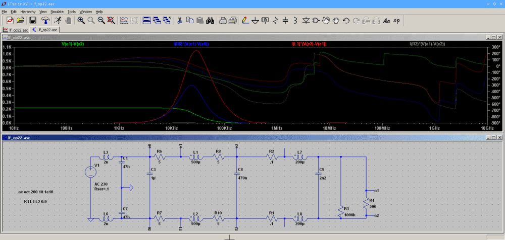

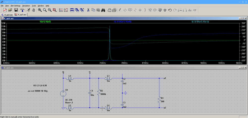

Dear forumers,

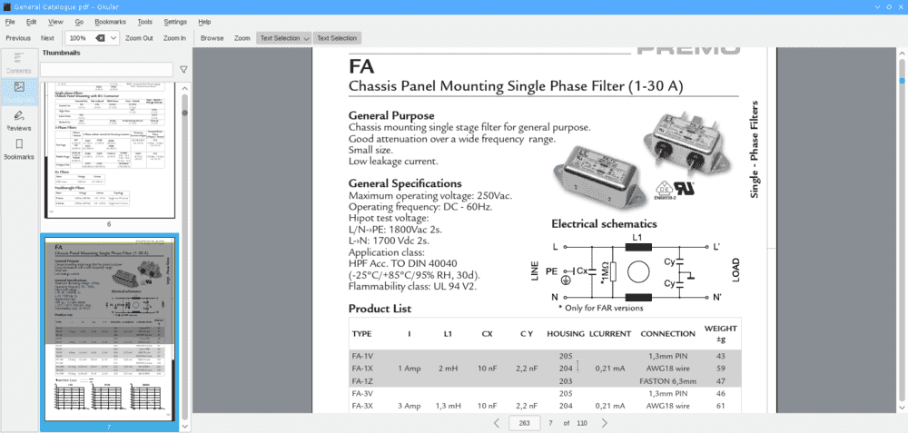

I have two high performance AC feedthrough capacitors (47nF, 100A, class Y2, DC-60Hz) which I want to either combine with a general purpose EMC line filter, or build a custom one to filter the mains from of about 100khz to as high as possible (for shielding purposes).
I can see in documents (like this one https://pdf.directindustry.com/pdf/premo/emc-filters/50493-247797.html) that the typical configuration for EMC filters are: X capacitor, discharge resistor, common-mode choke, 2xY capacitors.
I gave it a try in ltspice. A few schematics I saw on the internet simply placed spice's ground between the two Y capacitors. But to my knowledge, neutral is essentially on the same potential as PE, which would mean that another symbol must be placed on the neutral line in ltspice. And there is also cable impedance.
It would look like this:
or maybe this ?:

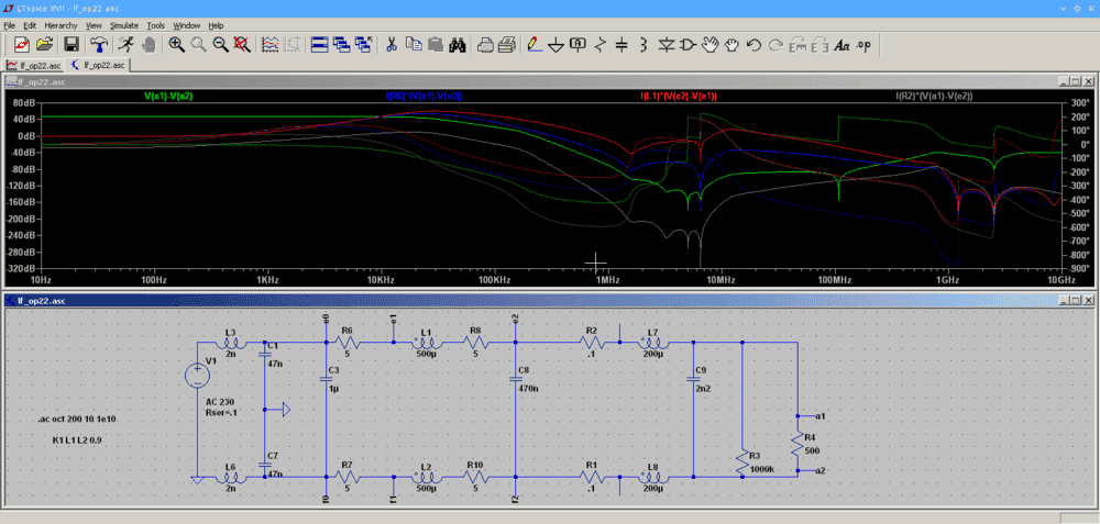

I gave approximate parasitic values for capacitors and inductors (.5 ohm and 20pF for L3 & L4, 1m ohm and 1nH for C1), but the simulation gives very strong resonances this way (~76khz, 270mhz) so I'm not sure if I'm doing it the correct way.
So is the schematic and the simulation correct this way?

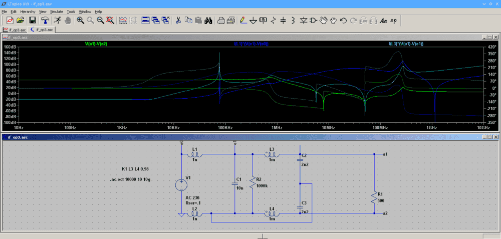

(L1 and L2 meant to be cable impedance, I assumed ~ 0.5ohm, 1nH, 1nF)By resonances, I mean if e.g. a 76khz signal were present on the mains line, it would cause excessive heating on L3 and L4. Is this correct or am I missing something here?
In another thread someone said that for line filters "The filters should not all be simple LC or RF choke filters, there must also be resistive snubbers, AC capacitor coupled, to absorb the reflected noise, or you will end up with all sorts of resonances." Source https://www.physicsforums.com/threa...feedthrough-filter-for-a-faraday-cage.956487/So I tried to place resistors in series with the inductors in another schematic, this greatly reduced those resonances (and voltage to 215-220vac) but probably still not what that person meant:
Or are these assumptions incorrect because published data is usually given for both common mode and differential mode and what I check here is the incoming voltage not noise?Another question is the place of the feedthrough capacitors. I saw in at least 2 documents that EMC filters can be combined with feedthrough capacitors in which case they don't simply replace the regular Y capacitors but place the feedthroughs after the regular y capacitors.
So would it be a bad practice to place the feedthrough right before the other EMC filter components (like in the 2nd spice schematics)?
The feedthrough on the neutral line would be shorted this way?Regards,
Akos
I would not ground Neutral in your simulation. At the most, you could ground it behind some model of the distributed impedance of the AC Mains (the connection is back at the breaker panel, which is usually far enough away that it will not affect the HF noise in the general case).

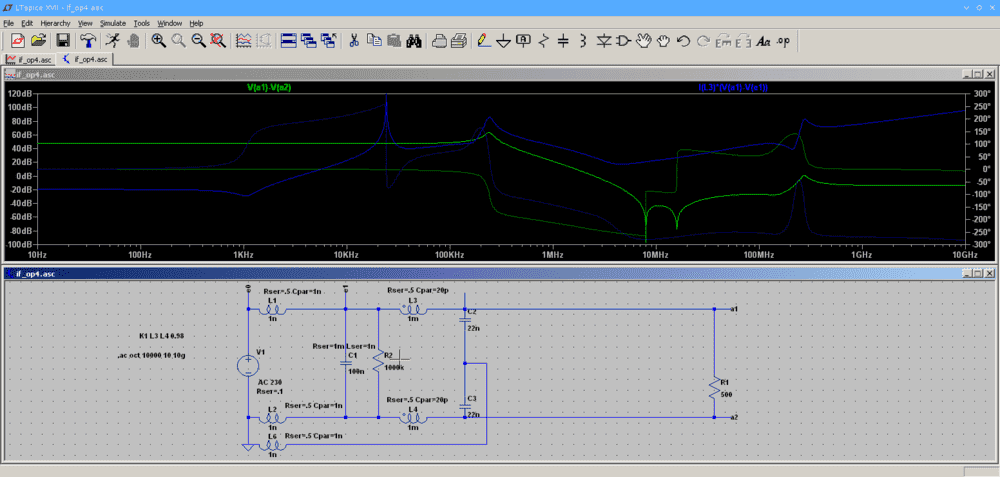

1. The PC SMPS is so noisy that noise from the mains entering the PC will not be a problem. It is the escape of RF from the computer, and from the SMPS, back out through the mains wiring that will be the problem.
2. The N–PE link is irrelevant to RF modelling. There is no need to model that link or the mains voltage. You are modelling RF so excitation should not be by 230V AC. Note that; if it was 230V AC then you would need to use 230V * √2 = 325V, since LTspice defines AC as peak voltage, not RMS.
3. The common-mode choke L3,4 effectively isolates the two sides of the supply. In LTspice the PE and N can be grounded to the same ground as the chassis.
4. The mains plug and 3 wire cable can be modeled as a 2 or 3 wire twisted pair transmission line. For RF purposes, a 2 wire line will appear to be about 120 ohms. I would model the mains supply simply as a 3 wire line terminated in a star of three 68 ohm resistors. RF radiation from the twisted wire transmission line is then proportional to the RF current through the line, or the RF voltage on the line.
5. The model schematic can be drawn and modeled backwards with standard AC 1 stimulus at PC on the LHS and RF radiation to mains on the RHS. You will then see sensible dB values for RF noise.
6. It is a mistake to try to do too much with one spice model. If you break the circuit into sensible chunks it will be easier to design and model. The mains filter is one module, maybe as far as the mains rectifier diodes where transient noise is injected. The mains power lead is an antenna and cannot be easily modeled with LTspice.
LTspice examples attached, remove the .txt extension.
