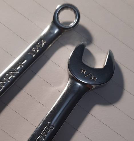

sophiecentaur said:
Is there anything at all interesting about 17/32"?? :wink:
Ha ha. I have these in my box, I'm sure I never used them.
This one I have used.

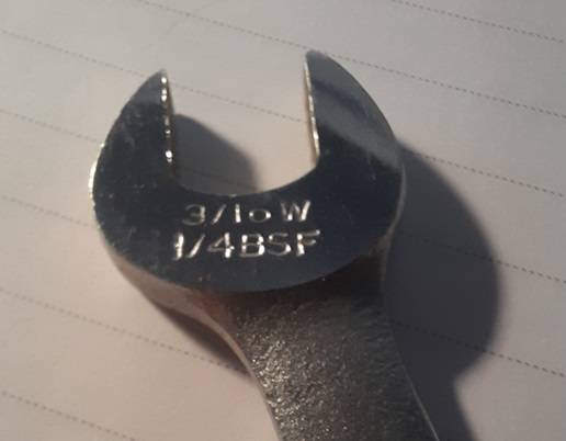

jack action said:
BSF? Best Spanner Forever?
British Standard Whitworth = BSW, standardised threads at 55°. Later, when metallurgy and machining tolerances improved, there was British Standard Fine = BSF, also 55°. The Whitworth spanners were marked for the size of the thread = the diameter of the bolt. That worked OK when Whitworth was the one and only standard.
60° UNC and UNF threads appeared in the US, then migrated to the UK during WW2. Obviously, the 55° BSW and BSF threads mismatched the 60° UNC and UNF threads. There were also a 60° BSC = British Standard Cycle thread, and (metric) 47.5° BA = British Association (of Engineers) standard threads.
With so many thread standards, a spanner in the UK, (wrench in the US), (key = clé in France), (key = schlüssel in Germany), (key = chiave in Italy), are now all specified Across the Flats = AF.
Some British spanners during the transition were marked with AF, as say 1/2"AF, to distinguish them from 1/2"BSW, or 1/2"BSF, but are now simply marked 1/2".
Standardisation has reduced costs and employment.
The number of inventory items that must be kept in stock as spares will fall gradually as old stock is used or scrapped.
I need a LH 1-1/4" BSF nut to repair an old saw bench. They used to be a commodity, but I could not find one available anywhere. It is not easy to cut left-handed internal threads in an old engine lathe, because the start of the cut cannot be seen.
