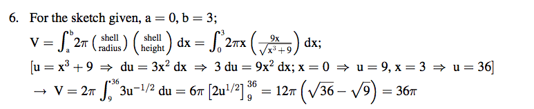

I understand about everything except why the b and a values on the integral change from 0,3 to 9,36

u = x3 + 9
so x = 0 -> u = 9,
so x = 3 -> u = 36 :smile:

I don't think it has any particular name. But if you express your final integral as a function of u, then the limits have to change to the limits for u. If you don't like that, then change the u back into x^3+9 at the end, so you've got 6π(x^3+9)^(1/2). Now use the original limits. It's exactly the same thing.

yes … and the name is u-substitution! :biggrin:
if you substitute u for x, you must do so wherever x occurs,
including in the the limits!
