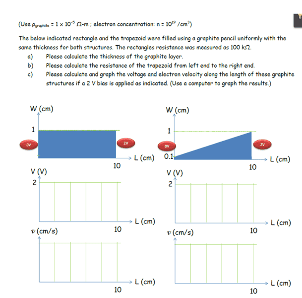

So I was wondering if someone could help with part C. I have gotten the answers for A and B, at least I hope they are correct.
So I'll just do the rectangle first and then try and solve the trapezoid. By the way do you think it's a triangle or a trapezoid? To me it loos like a trapazoid with a value at point l=0 of (0,.1) and not (0,0)?
Anyways for the rectangle...
So I'm given
rho, electron concentration - n, the thickness of the graphite layer - h (found in part a), and the velocity - v (I found it), and the voltage across the rectangle is 2 volts.
I'm confused as to how to find the voltage across the length. I thought that the voltage across the length would be a constant 2 volts but I guess I'm wrong.
Thanks for any help anyone can provide.
Voltage is 0 at the left side, and does not make jumps.
Current is constant, and resistance per length is constant. What can you tell about the voltage drop per length based on that?
I'm not exactly sure. If you rearrange the formula
R = rho(l/A)
And in this case indeed
R/l = rho/A
I can tell that from resistance per length is constant
from ohms law
V = I R
divide both sides by L
V/L = (I R)/L
V/L = I (rho/A)
so then Voltage as a function of length...
V(L) = (L*I*rho)/A
Now for I... I just use the fact that the resistance is given, 100k ohms and use 2 volts for the voltage
V = I*R
I = V/R
in the equation to find voltage as a function of length?
Well, you can use a shortcut: Once you know that voltage is a linear function, you can directly get the result from the boundary conditions: 0V at the left side and 2V at the right side.

Ok I guess I'm doing something wrong as my answer to C for the voltage makes no sense. Thanks for any help. I have shown all steps.
For part (a)
R = 100 kΩ
l = 10 cm
ρ = [itex]10^{-5}[/itex] Ωm
R = [itex]\frac{ρl}{A}[/itex]
[itex]\frac{1}{R} = \frac{A}{ρl}[/itex]
A = [itex]\frac{ρl}{R} = \frac{10^{-5} Ωm(10 cm)kΩ(100 cm)}{(100 kΩ)(1000 Ω) m} = 10^{-7} cm^{2}[/itex]
A = wh, [itex]h = \frac{A}{w} = \frac{10^{-7}cm^{2}}{cm} = 10^{-7} cm[/itex]
For part (b) trapezoid only
R = [itex]\frac{ρl}{A}[/itex], [itex]\frac{1-.1}{10}l + .1 = .09 l + .1 = w[/itex], A = wh, A(l) = (.09l + .1)[itex]10^{-7} cm^{2}[/itex]
R(l) = [itex]\frac{ρl}{A(l)}, R = \frac{10^{-5} Ωm (100 cm)}{10^{-7}cm^{2}m} ∫^{10}_{0}\frac{l dl}{.09l + .1}dl ≈ 471.889 Ω[/itex]
I = nqvA, I = [itex]\frac{V}{R}, \frac{V}{R} = nqvA, <br /> v = \frac{V}{RnqA} = \frac{2 V}{471.889 Ω\frac{10^{19}}{cm^{3}}(1.6*10^{-19})(.09l+.1)(10^{-7}cm^{2})} = \frac{2648866.285}{.09l+.1} \frac{cm}{s}[/itex]
V = IR, I = [itex]\frac{V}{R} = \frac{2V}{471.889 Ω} ≈ 4.238*10^{-3} A[/itex]
R = [itex]\frac{lρ}{A}, \frac{R}{l} = \frac{ρ}{A}, V = IR, \frac{V}{l} = \frac{IR}{l} = \frac{Iρ}{A}[/itex]
[itex]V(l) = \frac{lIρ}{A} = \frac{l4.238*10^{-3} A(10^{-5} Ωm)(100 cm)}{(.09l+.1)10^{-7}cm^{2}m} = \frac{l42.38}{.09l + .1}[/itex]
The last two lines are problematic:
##\frac{dV}{dl}=\frac{I\rho}{A}##
It is the derivative here.
##V(l)=\int_0^l \frac{dV}{dl} dl' = \int_0^l \frac{I\rho}{A(l')} dl'##
Where A depends on l at the trapezoid.

Ok so for the cross sectional area of the trapezoid...
dA = h * w(l) * dl
So
A(l) = 10^(-7) integral[0,l] [.09*l+.1]dl
Wait so is the information you provide in your post correct?
Do you have a reason to expect wrong formulas?
That (A in post 8) is not the same A you used above.
You don't need any integral to express A.

So
[itex]\frac{V}{l} = \frac{Iρ}{A(l)}[/itex]
[itex]\frac{dV}{dl} = \frac{Iρ}{A}[/itex]
V(l) = [itex]∫^{l}_{0} \frac{dV}{dl} dl = ∫^{l}_{0} dV = V[/itex]
I calculated earlier that
I = 4.238*[itex]10^{-3} A[/itex]
and
A(l) = (.09*l + .1)[itex]10^{-7}cm^{2}[/itex]
So
V(l) = [itex]∫^{l}_{0} = \frac{4.238*10^{-3} A (10^{-5} Ωm (100 cm)}{(.09l + .1)10^{-7}cm^{2}m} dl[/itex]
I don't is right because when I plug in 10 I get about 423.8
Probably a numerical issue somewhere. Your resistance for the trapezoid is wrong - it has to be more than 100 kΩ (if you remove conductible material, the resistance increases), probably ~300-600 kΩ (471kΩ?)
Ok thanks, I think I found my mistake and got the correct answer. I actually didn't get 471k for the resistance of the trapezoid? Is that what I'm supposed to get? I did find that my answer for the resistance for the trapezoid was indeed wrong but that's not what I got when I found the correct answer to that. Well I don't know if it's correct but when I plugged it into find the current and used that in my voltage equation and then plugged in 10 cm I got 2!

471kΩ was just a guess, based on your previous value of 471Ω. I did not calculate it.
The velocity in the square should be the same everywhere, you can calculate it with the known cross-section area, current and material constants, and they are all independent of l.
