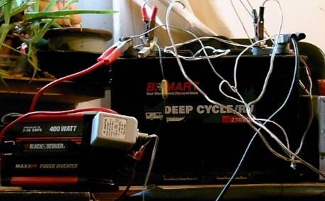

My immediate solution to the problem:
Purchase a 12VDC to 120VAC converter: $40
Purchase a decent battery charger: $40
Connect the converter to your "bank", and keep your starter motor battery fully charged.
The converter will squeal when the "bank" voltage drops to a certain level.
When the converter starts squealing, consider either investing in about $100 worth of solar panels, or start the motor.
