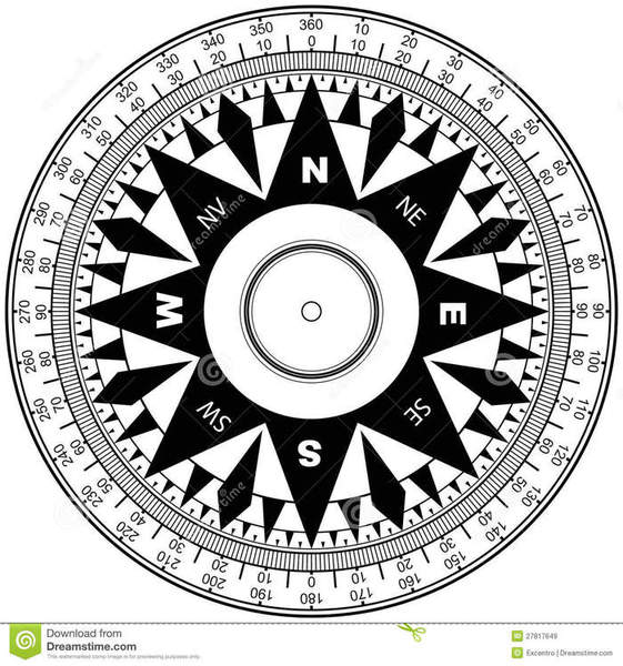

You need to make a sketch.
Take the first movement of the ball, which is 4.00 m to the north. How would you show north on your sketch?
Second movement, 2.00 m to the northeast. Which direction is northeast? Is northeast at right angles to north?
If you are having trouble visualizing a compass, here is a sketch of one:
So if I'm not given a specific angle I should assume that whatever the direction is that's what the angle is? e.g northeast points to a 45º angle
so i would do
2cos45=
2sin45=
so i would do
2cos45=
2sin45=
Yes.
Directions are equivalent to angles; you just have to know how to read a compass.
There are certain cardinal compass directions, like north, south, east, and west, which are pretty obvious. There are also some intermediate compass directions, like northeast, etc., which are also common. For less common compass directions, you have expressions like "30.0° west of south", which describes the heading to take.
Thank you so much for the help, I understand it much better now !
