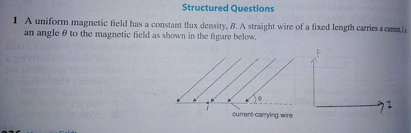

according to my book, there's no graph for F versus I , can someone expalin why? based on my understanding it should be a straight line graph ( directly propotional) since F= BIL SIN TETHA

For any given layout, F vs. I should be a sloping straight line. I see no evidence of your textbook implying otherwise.

do u mean my textbook ans is wrong?
You haven't shown the textbook's answer. (A hand-drawn sketch is not reliable.)

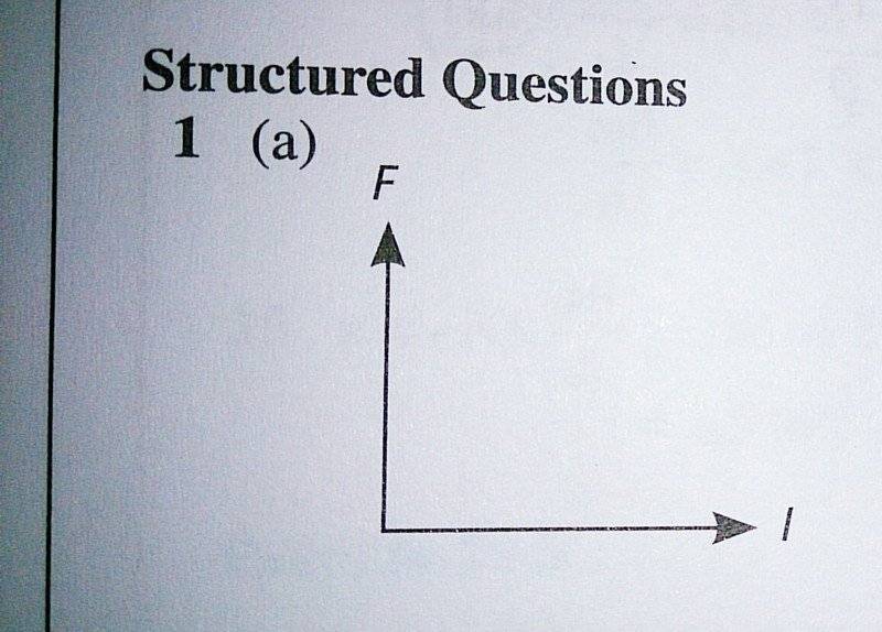

here's the ans from my book... so how should the graph be? can you show here?

I guess your textbook is supplying a blank graph for you to fill in? Or maybe the author simply forgot to hand draw the graph before the book went to the printers.
Just draw in a straight line through the origin, of some general slope. If you were asked to indicate the slope, what expression would you write?
