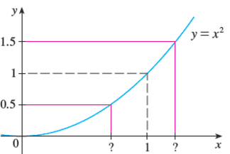

Use the given graph (see attachment) of [itex]f(x) = x^2[/itex] to find a number δ (delta) such that
if: [itex]|x-1|<δ[/itex] then: [itex]|x^2-1|<\dfrac{1}{2}[/itex].
(Round your answer down to three decimal places.)
No equations used.
I need to find the smallest value of δ
[itex]x^2=0.5[/itex]
[itex]\sqrt{x^2}=\sqrt{0.5}[/itex]
[itex]x=0.707106781[/itex]
[itex]x^2=1.5[/itex]
[itex]\sqrt{x^2}=\sqrt{1.5}[/itex]
[itex]|x-1| ---> |8-0.0701067|=7.292893[/itex]
[itex]|x-1| ---> |8-1.224744871|=6.775255[/itex]
Now I would pick the smaller value and round:
[itex]6.775[/itex]
I use WebAssign, and it says I got it wrong. I don't know what I should try.

Your value for δ is way too large. You want an interval around x = 1 on the x-axis so that the y values on the graph are between .5 and 1.5.

Uh oh, I have no idea why i was subtracting 8 when it says | x - 1 | in the question. Thanks for saying that Mark, I got 0.225 and got it correct. Thank you!

Why bother finding the smallest possible value of ##\delta > 0##? The question does not tell you to do that; it just tells you to find a ##\delta## that "works".
Well this is what happens:
[itex]|x-1|--->|1-0.0701067|=0.2928932[/itex]
[itex]|x-1|--->|1-1.2247448|=0.2247448[/itex]
Now I rounded the first one 0.293 and it says:
"Please try again. For finding δ such that |x − a| < δ implies |x2 − a2| < b, start by finding the solutions to |x2 − a2| = b. Choose δ so that neither of these solutions are at a distance smaller than δ of a."
So that's why I had to choose the second line instead.
