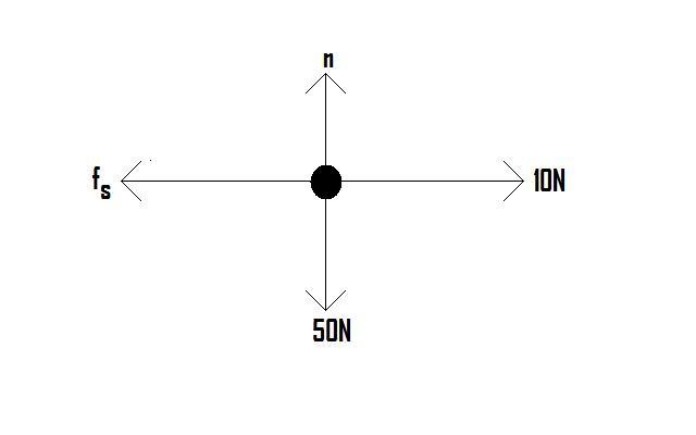

A crate with a weight of [itex]50N[/itex] rests on a horizontal surface. A person pulls horizontally on it with a force of [itex]10N[/itex] and it does not move. To start it moving a second person pulls vertically upwards on the crate. If the coefficient of static friction is [itex]0.4[/itex], what is the smallest vertical force which will move the crate.
[itex]f_s=\mu_sn[/itex]
Free-body diagram of a point mass with four forces: n upward, 50N downward, f_s to the left and 10N to the right.
[itex]R(\rightarrow): 10 - f_s = 0 \implies f_s = 10N[/itex]
[itex]f_s=\mu_sn_{tot} = (0.4)(n_{tot}) = 10 \implies n_{tot} = 25[/itex]
[itex]n_{tot} = F_y+n \implies F_y = 25-50 =-25N[/itex]
4. The problem I encounter
Can you check my method please. I got [itex]-25N[/itex] which is negative hence this is giving me a doubt. Thanks.

You did everything correctly. The reason for the negative is that your calculations used a downward direction as positive. Thus, your -25 N answer means the 25 N force will be applied upwards.
What is [tex]n_{tot}[/tex]? The normal force is just [tex]n[/tex] . The applied upward force is [tex]F_y[/tex]. The crates weight is 50N down. You've got a couple of 'n's' in your equation that need to be corrected.

How can you tell that I took downwards as positive? Even if I resolve upwards I would get: [itex]R(\uparrow) : n - 50 = 0 \implies n=50N[/itex]?

My [itex]n_{tot}[/itex] is just a notation I gave for the total force in the upper direction which would be the [itex]F_y + n[/itex]. I should have given that another notation but what's wrong other than that, is my calculation correct?

The static friction is μn, where n is the normal force (not ntot). So μn = 10, thus n = 25.
[tex]n_{tot} = F_y+n \implies F_y = 25-50 =-25N[/tex]
The vertical forces must add to zero:
Fy + n - 50 = 0 (Where Fy is the applied vertical force.)
Solve for Fy.
Solve for Fy.
Ah yes, that gives a positive answer, ##F_y = 50 - 25 = 25N##.
The problem was that I took the vertical force combined with the normal force to equal the normal force and used that in the equation.
It makes sence. Thanks to everyone for the help.
