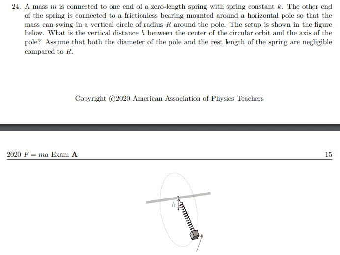

Problem 24 in US Physics Olympiad FMA packet A
F=ma

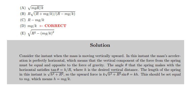

Because this problem is easier to understand with a picture, I'll just copy paste the original problem. There is no question about the validity of the solution. My question is about the statement in the solution
"Consider the instant when the mass is moving vertically upward. In this instant the mass’s acceleration is perfectly horizontal, which means that the vertical component of the force from the spring must be equal and opposite to the force of gravity."
I know in fact this is a correct statement, however, is there a simple logical argument to support this statement.

Following @hutchphd in post #16, let ##\vec R## locate the position of the particle ##P## relative to the fixed point ##A## where the spring is attached to the collar. Define vector ##\vec h = m \vec g /k## which locates a fixed point ##C## relative to A. Define ##\vec r## as the vector locating ##P## relative to ##C##. Note that ##\vec r = - \vec h + \vec R##.
The net force on ##P## is ##\vec F_{net} = m \vec g -k \vec R =- k(- \vec h + \vec R) = -k \vec r##. So, the net force always acts toward the fixed point ##C## with a magnitude proportional to ##r##. The net force is a central, attractive force relative to ##C##. So with appropriate initial conditions, the particle can move in uniform circular motion about ##C## with any radius.

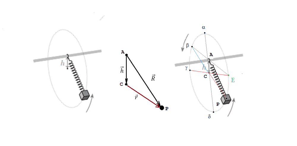

Below is the drawing from the problem statement, with your drawing, and a third drawing that uses some features of your drawing combined with the one from the problem statement:
The trajectory of mass ##\text P## about axis ##\text A## is elliptical, and about point ##\text C ## it is circular. The equilibrium point is at ##\text E##. At point a the velocity is entirely inertial. Then from point a to point d, gravitational acceleration translates at least partially into the elongation of the spring to maintain the center of the circle of orbit at point ##\text C##. Then from point d to point a, gravitational deceleration shortens the spring.
The vertical component of the spring force is equal and opposite to the gravitational force only at the equilibrium point. It diminishes as the ##\theta## angle goes from 90° at point ##\text E## to 0° at point a.
Given that ##a_c=−ω^2r## (inverse (toward the center) radial acceleration is proportional to the product of the square of the angular velocity and to the radius of the circular path), ##\cdots## to be continued ##\cdots##
