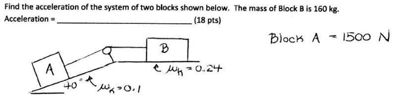

What is the tension force in each block on an incline?

I can write out all the sums in the X and Y direction but don't know what to put for the tension force of each block...i can't assume 1500N for tension in block B correct? because its on an incline and all that. and then how do i do the acceleration of the system? wouldn't i have 2 separate accelerations for each block?
You cannot assume any value for the tension. Just call it "T" and include it in your analysis.
The blocks are connected by a rope, so they have the same acceleration.
Applying Newton's 2nd law to each mass separately, you'll end up with two equations and two unknowns. Just right.
ahhh then use substitution correct?
for the A block the tension force would be going North East correct? and same with the MA force and (coeff. of friction*N) force since its sliding down?
That would work.
Both the tension and the friction force on block A act up along the incline (North East, if you like). I don't know what you mean by the 'MA force'. The acceleration is down the incline.
mass * acceleration force.
That's not a force, that's mass*acceleration. If you were to list the forces acting on either block, you would not include 'mass*acceleration'. That term appears when you apply Newton's 2nd law.
