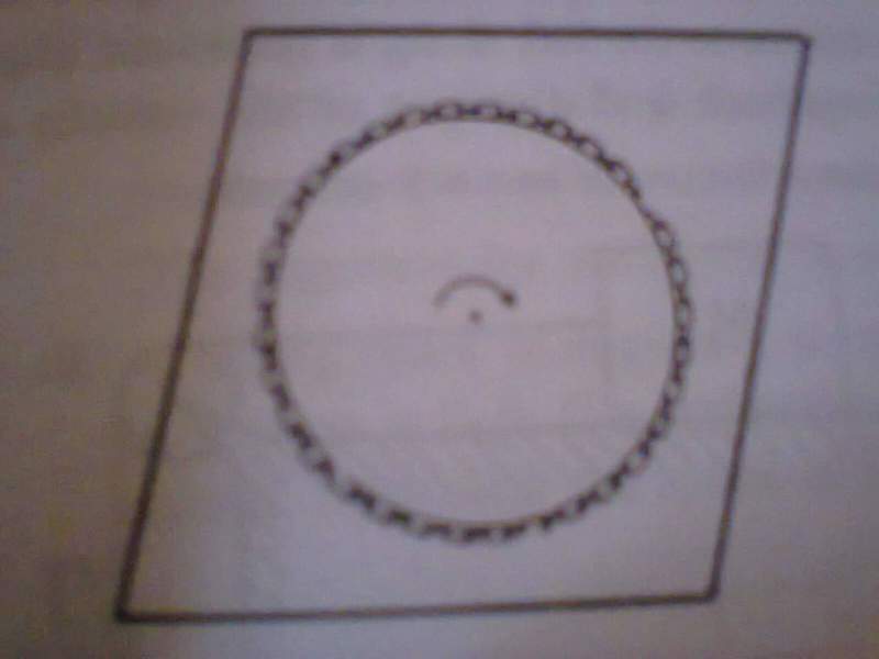

A metallic chain with a length ‘l’ andd whose ends are joined together is fitted onto a wooden disc as shown in the figure.The disc rotates with a speed of n revolutions per second.Find the tension of the chain T if its mass is m.
Honestly I have very little idea about how to approach this problem .
All I know is that every part of the chain is undergoing centripetal acceleration as the chain is rotating .Since the speed is constant there would be no tangential acceleration.
ω = 2nπ
Please help me with this problem .
Thanks .

Well, centripetal acceleration requires a centripetal force. What can possibly be the source of that force ?
Think of a ring of people holding hands and dancing around with considerable speed. What if a hand let's go ?

Component of tension in the radial direction. But how do I find that component ?
The ring will fall apart .
To find that radial component, draw a section of the chain and note that the vector sum of the tensions points just where you want it !

I still don't understand how to approach this problem.
Doesn't the wooden disc play any role in providing centripetal force to the chain ?
Not really. How could it? All it can do is push radially outward (a normal force!), which doesn't help: it is in an altogether wrong direction ! Iron doesn't have a tendency to stick to wood by some physical force...
Did you draw a section of the chain and discover how the sum of the tensions working on it points in a desirable direction ?
