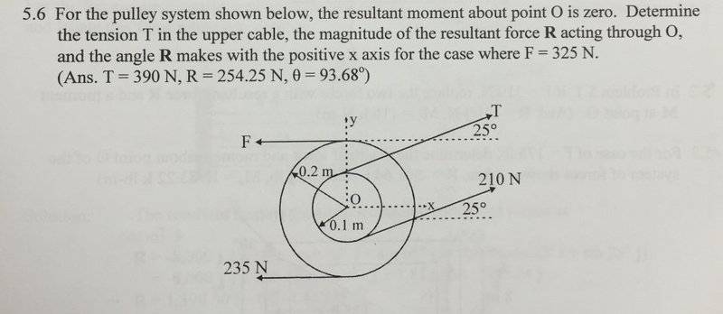

What is the torque exerted by T about point O?

The problem is shown in the image attached.
∑F = -235i -Fi +Tcos25i + Tsin25j +210cos25i +210sin25j
Moment = r x F[/B]
I have tried various things. I tried summing all the moments and then setting that equal to zero to find T. I have tried just adding the forces and setting equal to zero to find T. None of these approaches have helped so far. Right now I am just interested at find T. Could someone just point me in the right direction to start. Thanks much.
That approach will find T. Show your work and we'll see what went wrong.
Chose the positive for finding moment. You must use ΣM=0.
Note M=||rxF||=r.F.sina
