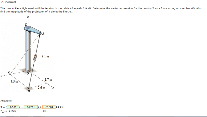

The turnbuckle is tightened until the tension in the cable AB equals 2.9 kN. Determine the vector expression for the tension T as a force acting on member AD. Also find the magnitude of the projection of T along the line AC.
I was able to find the vector expression for T without any real trouble:
AB = <2.6, 1.7, -6.1>
|AB| = sqrt(2.62+ 1.72 + (-6.1)2)
T*AB/|AB| = 0.42364<2.6, 1.7, -6.1>
T = 1.101i + 0.7201j - 2.584k
I know this part is correct but I'm having difficulty doing the projection.
I tried taking taking the dot product of the T vector with the unit vector AC:
AC = ,2.6, -2.8, -6.1>
|AC| = sqrt(2.62 + (-2.8)2 + (-6.1)2)
|AC| = 7.1979
AC/|AC| = 0.3612, -0.389, 0.8475
T°AC/|AC| = 1.101*0.3612 +(-0.389*0.7201)+(-0.8475*-2.584)
= 2.2746
But it says my answer is wrong and I'm not sure where I'm going wrong.
Advice would be greatly appreciated.

Isn't the z component of the unit vector AC/|AC| supposed to be negative?
Yes it is; it's a typo, but I did include the negative in the calculation below that.
Code:
octave:20> T=[1.101;0.7201;-2.584] < the tension vector[/color]
T =
   1.10100
   0.72010
  -2.58400
octave:21> C=[2.6;-2.8;-6.1] < this is AC vector[/color]
C =
   2.6000
  -2.8000
  -6.1000
octave:22> sqrt(C'*C) < |AC| = √AC.AC[/color]
ans =  7.1979 <---<<< agrees with your value[/color]
octave:23> C=C./sqrt(C'*C) < set up unit vector[/color]
C =
   0.36122
  -0.38900
  -0.84747
octave:24> T'*C
ans =  2.3074 <---<<< does not agree with yours[/color]
... it follows, unless I messed something up above, that you've made a mistake in your arithmetic someplace - go over it again, slowly.
I think your method is sound ... the projection ##p## of ##\vec{u}## on to ##\vec{v}## is $$p=\frac{\vec{u}\cdot\vec{v}}{|\vec{v}|}$$
I ran my calculations again. You answer is correct. I must have made a mistake when I typed in the numbers into my calculator. Thank you.
Those are the hardest mistakes to spot - especially if you make the same number-punch error repeatedly.
