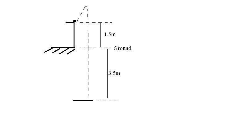

A body is thrown vertically upward from the distance h = 1,5 m above the ground at the
edge of a pit having a depth of s = 3,5 m. The initial velocity of the body is 2,3 m/s.
Determine the velocity at which the body will reach the bottom of the pit.
(h=5m)
V2-V02=2gh
V=10.168 m/s
What a violent problem...
I'll give you a hint, the initial height is 1.5m, but the total height is 3.5m.

really ?
chawki said:
(h=5m)
V2-V02=2gh
V=10.168 m/s
Looks good.

regarding this actual problem, I'm starting to think that flying pig is right :/
Why is that?
Take Doc Al's advice. I just glanced over the problem and your equation. I just saw that you missed the initial height in your equation, so I jumped into a conclusion lol

This is how I'm imagining it...
Am i right ?
chawki said:
Am i right ?
Yes.
Doc Al said:
Yes.
Thank you :smile:
i think you're right boy .. here's my solution
v^2 = Vo^2 - 2gy
Vo=2.3m/s
y=1.5+3.5 = 5m
V=2.3^2 -2(9.8)(-5)
V=10.16m/s downward ..
:approve:
