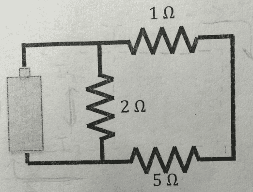

Three resistors are connected to a real battery. The open circuit voltage of the battery is 4.5 Volts. The voltage across the 5 Ohm resistor is 2.5 Volts.
A) What is the voltage across battery terminals?
B) What is the internal resistance of the battery?
Here's a picture of the circuit: http://imgur.com/7IdSn3I
Circuit schematic: a battery on the left feeds a network of three resistors labelled 1 Ω (top right), 2 Ω (vertical middle branch) and 5 Ω (bottom right), forming a closed loop.
Junction Law: Sum of Current in = Sum of Current out
[/B]
I understand how a real battery has an internal voltage and resistance, but I don't know how the information here relates to that. I tried using the Junction Law to find different Currents I_1 and I_2 but even after getting those I didn't know how to relate that to the questions.
Can you show what calculations you've done and which currents you've found (they were not marked on your figure)?
