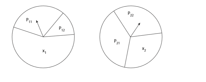

Problem:
Here’s a little Monte Carlo challenge problem, Consider the following game, which uses the two spinner disks. Suppose a player spins one or the other of the pointers on the disks according to the following rules: (1) if the player spins pointer ##i## and it stops in the region with area ##p_{ij}##, he moves from disk ##i## to disk ##j## (i and j are either 1 or 2); (2) if a pointer stops in the region with area ##x_i##, the game ends; (3) if the game ends in the region with area ##x_1##, the player wins, but if the pointer stops in the region with area ##x_2## the player loses. What is the probability the player, starting with disk 1, wins? Assume the area of each disk is one, so that ##x_1+p_{11}+p_{12} =1##, as well as that ##x_2+p_{21}+p_{22} =1##
Run your code for the case of ##p_{11} =0.2, p_{12} =0.4, p_{21} =0.3##, and ##p_{22} =0.35##.

The correct answer is 0.5821 however I am getting 0.655.. Where am I doing wrong ?

How do you know what the correct answer is? Also, it's a good idea to use random.seed() to seed the random number generator, but it doesn't seem to make much difference here.
I don't think your code captures what's supposed to happen here due to it being too simplistic. Based on your description, the pointer on the first disk can land on ##x_1## or ##p_{11}## or ##p_{12}##. If it lands on ##x_1##, that's a win for that turn. If it lands on ##p_{11}##, nothing happens for that spin. If it lands on##p_{12}##, you spin the pointer on the second disk.
If the second pointer lands on ##x_2##, that's a loss for that turn. If it lands on ##p_{22}## nothing happens, but if it lands on ##p_{21}##, the turn continues on the first disk.
I haven't seen how the game is defined, but I would bet it's something like I have described. If so, you need to take into account conditional probabilities, and all possible paths to a win for a given turn. The game makes me think of it as being a Markov process.

I noticed that there is an error in the book. The real answer is 0.65 and I edited my code like this which it works now. So problem is solved.
