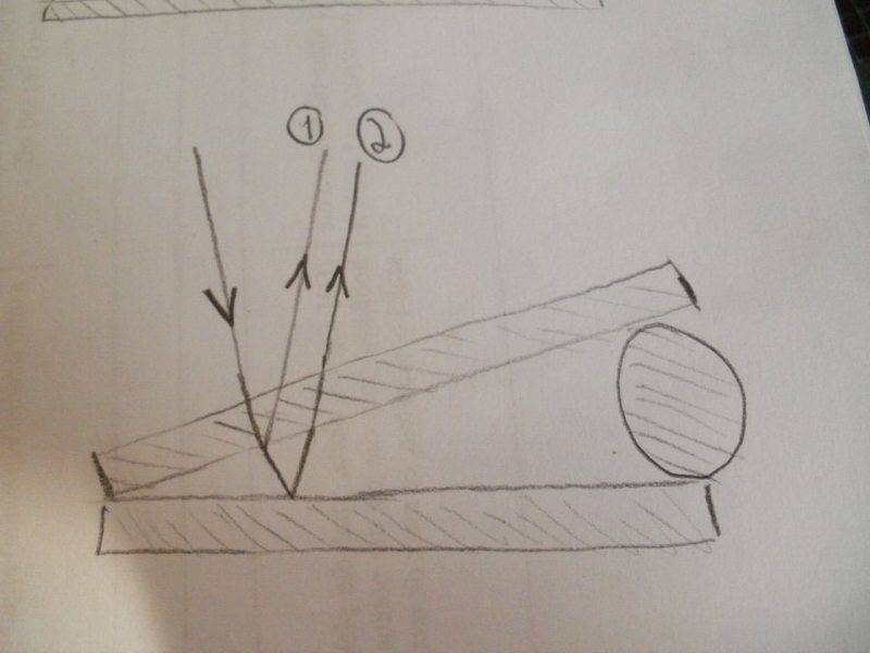

One microscope slide is placed on top of another with their left edges in contact and a human hair under the right edge of the upper slide. As a result, a wedge of air exists between the slides. An interference pattern results when monochromatic light is incident on the wedge. What kind of fringe is seen at the left edges of the slides?
A. a dark fringe
B. a bright fringe
C. a circular fringe
D. impossible to determine
2nt=mλ and 2nt=(m+0.5)λ
A is the correct answer but I honestly have no idea how to approach this.
How are the interference fringes created?
Aren't they created when the reflections of light interact by constructive and destructive interference? Which is caused by some light rays moving a further or lesser distance.
Yes, but where are the light reflected from?
Is the light reflected from the surfaces of the slides?
Yes, but more correctly at the top and bottom of the air-glass interface.
Oh okay.
So how would you be able to tell using that information whether dark and bright fringes were produced?
The two beams are combined in the eye and they interfere with each other.
What do you think would happen it two beams from the left hand side
of the wedge of air would interfere with each other?
Oh it makes sense now. They would interfere destructively at the end
I think it is important to note that when light reflects off of the surface of a material that is "less optically dense" it does not undergo a phase change. However, if it does reflect off the surface of a more optically dense material then it does undergo a phase change of 180 degrees. As the distance between the second air-glass interface and the third air-glass interface approaches zero, the phase difference of the light reflected from them approaches 180 degrees. Thereby the left side appears darker than the right.
